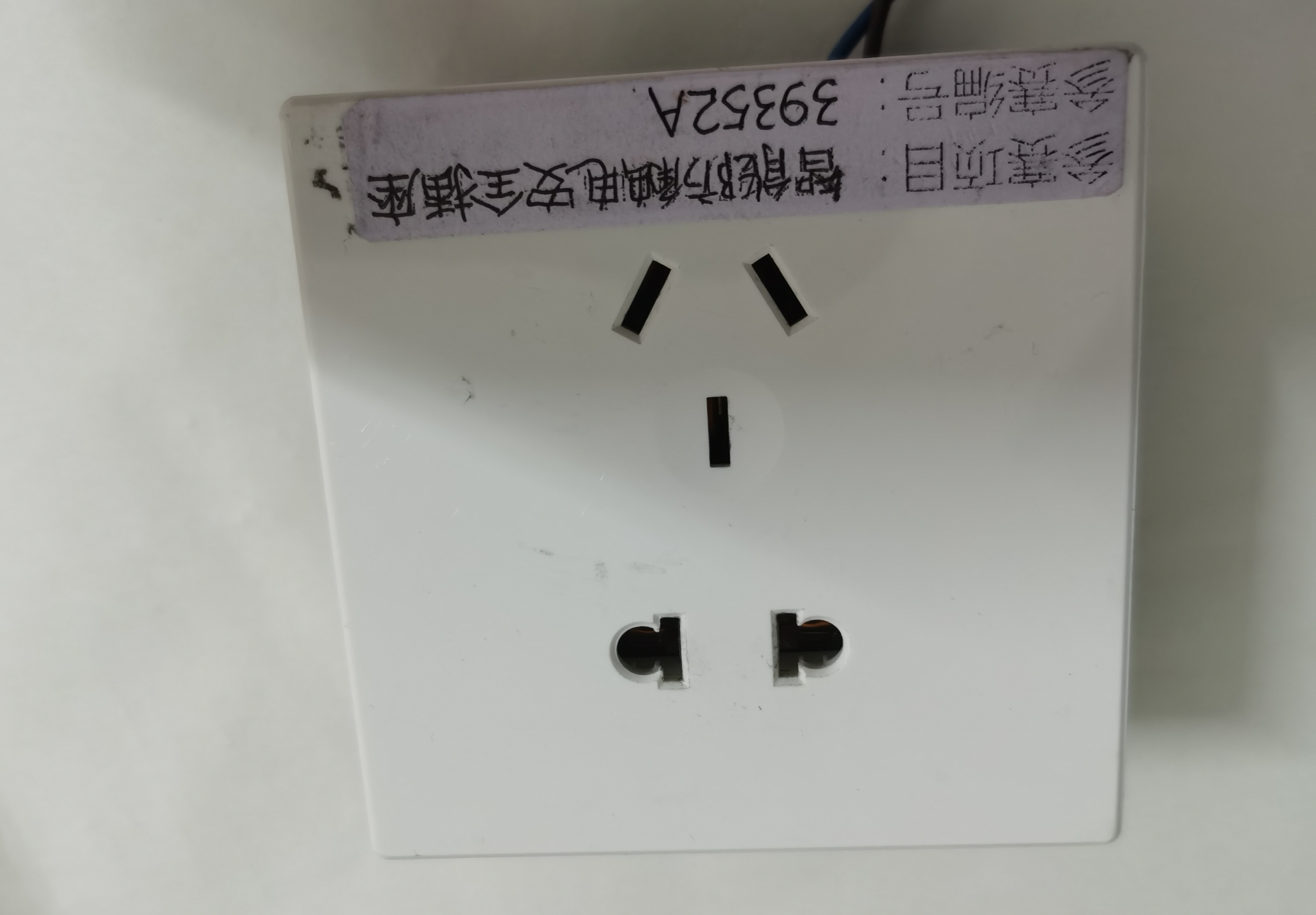

5. Upload project pictures 5.1. Print the competition logo picture on the PCB. Failure to do so will be considered as giving up the competition
5.2. Other pictures of the project
