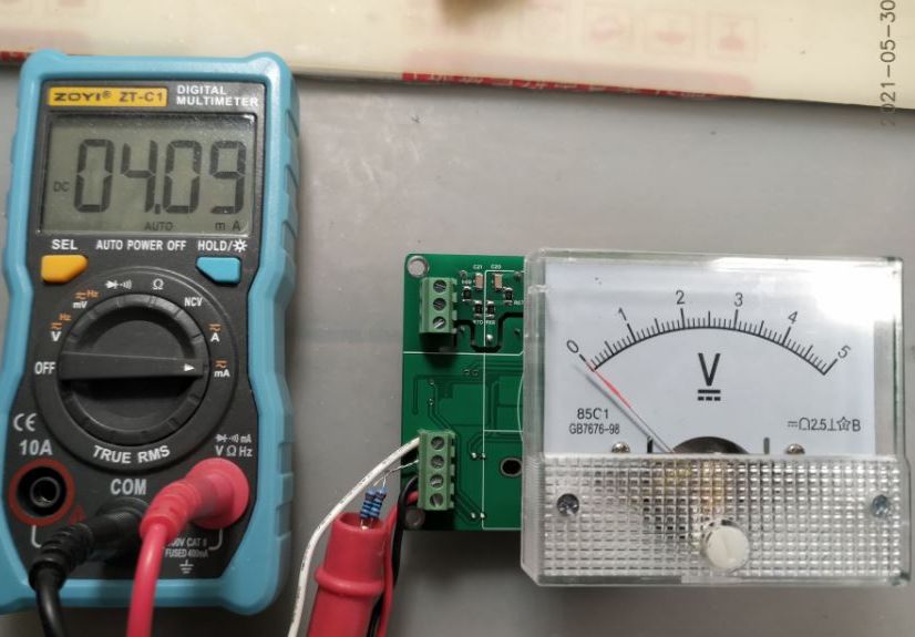

In the era when MCU was too expensive, analog circuits and pointer tables were used. (MP-4 sensor) realizes gas alarm.
The main function is to detect the methane content in the air, such as > 1000PPM, sound and light alarm, and relay action.
USB power supply or (12V-24V) power supply, 4-20ma output mode can be provided when powered by 24V.
The MP-4 sensor requires a heating power supply and a power supply on the sensor side. It needs to be warmed up for at least 60 seconds.

After pressing the test button SW1, a 30K resistor is connected in parallel to the sensor, and the voltage should be about 150mV (ignoring the sensor resistance, theoretical value). The pointer meter is around 1.5V. The buzzer sounds, the relay closes, and AL3 lights up.
The current output is about 11.5mA. 150mV amplifies 1.5V 10 times, to U8, (0.8V + 1.5V)/2=1.15V. converted to 11.5mA.
Can be used to test whether the back-end circuit is normal.

The circuit board debugging is completed and there are two flying wires. The verification function is normal.
The circuit has been modified and the schematic and PCB have been updated.
The video has been updated https://www.bilibili.com/video/bv1sK4y1R7r9
---------------------------------------2021.6.15-------- ----------------------------
Supplementary instructions on using tweezers to short-circuit the resistor in the video:
1) Short-circuit the sensor current sampling R11, which is equivalent to the sensor heating group being open-circuited, there is no current, the voltage is zero, the amplifier output is zero, and a low-frequency alarm occurs.
2) Short-circuit sensor output R17, which is equivalent to sensor output zero and low-frequency alarm.
3) Short-circuit the power-on preheating resistor R5 to quickly charge CAP3, increase the voltage, and turn off the alarm.
In addition, the measured oscillator circuit can work normally. After the oscillator works for about 60 seconds, the lowest voltage of -0.4V will indeed be generated on C12, but it will not breakdown Q5.
