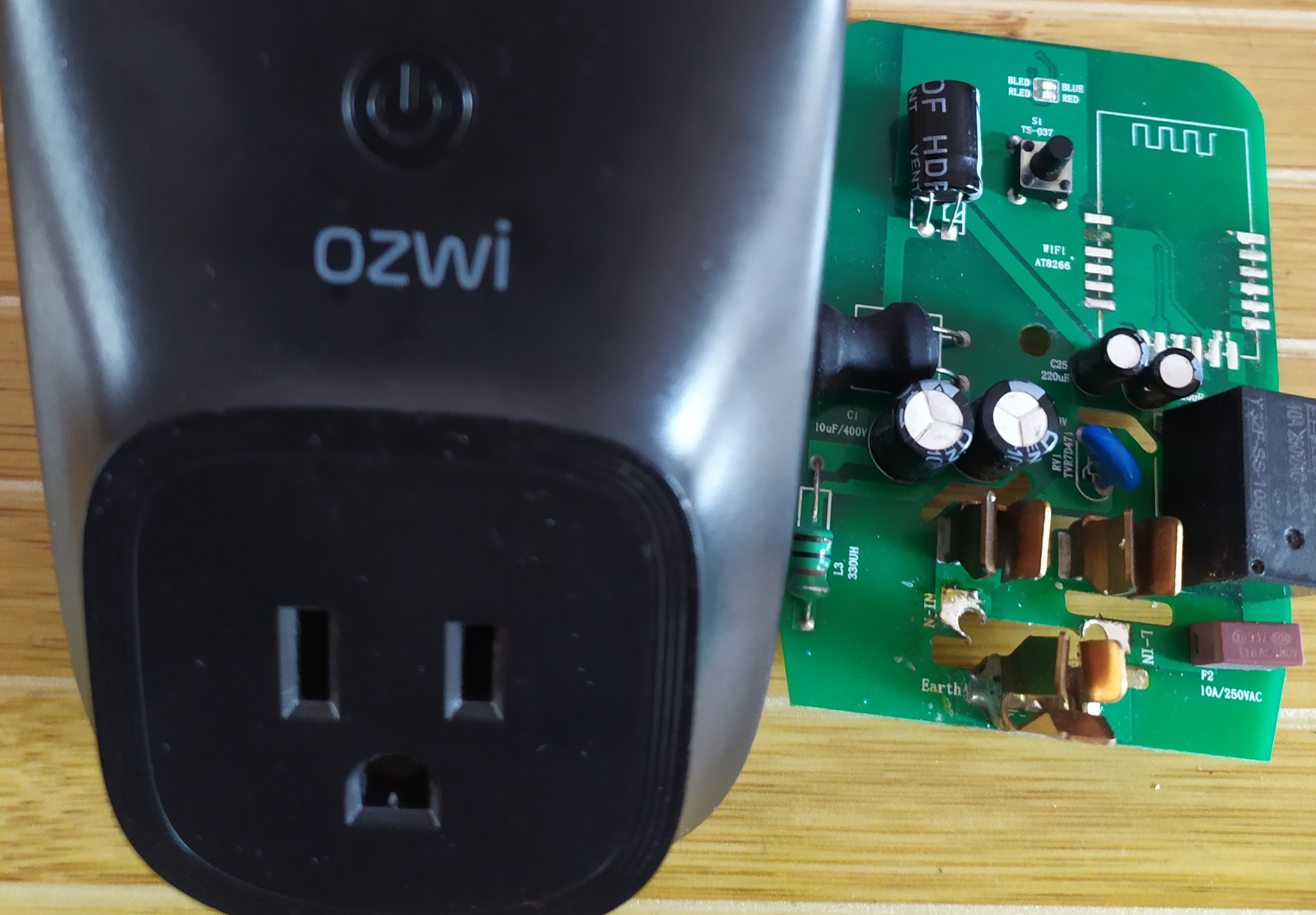

The OZWI socket 8266 module is flashed with lighting technology and connected to Tmall, Xiaoai, and Xiaodu.
        The ESP8266 smart socket based on Arduuino programming cannot be connected to other platforms because the original ozwi.app crashes from time to time.
So I came up with the idea of ​​rewriting a program. No need to touch the socket hardware.
       Tmall Genie and Xiaoai classmates have been tested, but it cannot be tested because there is no Xiaodu speaker. Install blinker on your mobile phone, Tmall Genie, Mijia bind blinker account.
       It is best to replace the 1MBit flash of the wifi module with 4MBit, such as 25Q32, 25L32 and so on. (Because I found that using the original 1MB flash, after the network configuration was successful,
it could not automatically connect to the home wifi after powering off and replugging it. The network had to be reconfigured every time. Changing to a 4MB flash could solve the problem.)
       Use Anxinko for network distribution . No public.
