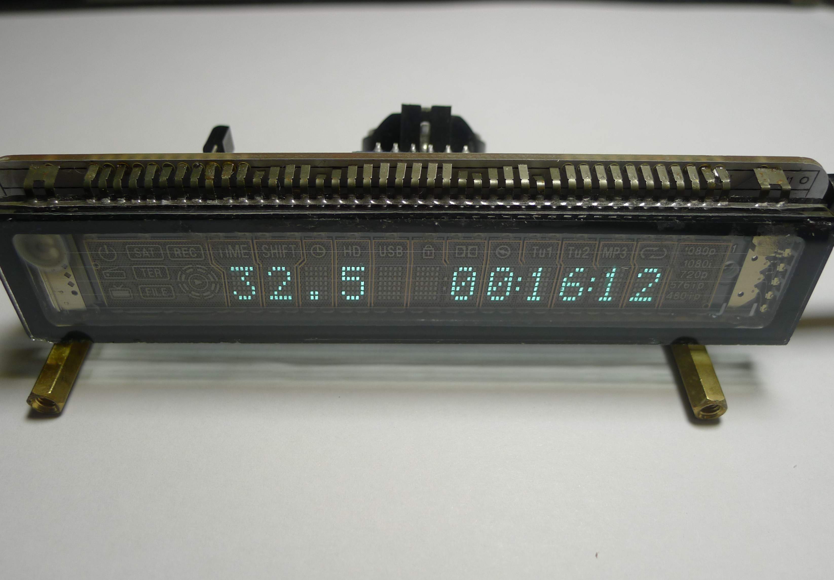

It is suitable for the 13-ST-84GINK VFD base plate previously sold by Laowang Electronic Digital on the next door forum.
A simple clock.
1 (1).jpg1 (3).jpg1 (2).jpg Supports time setting, temperature display, and aging correction.
The program is at https://gitee.com/LC_391338A/GIT_13_ST_84GINK_Clock
Known issues:
1. Due to the layout, the temperature of DS18B20 is relatively high. It is recommended to use a socket instead.
2. USB power supply, the output voltage of the transformer may be insufficient~~, and the brightness may be dim~~.
3. The number of days is not considered when setting the month.
