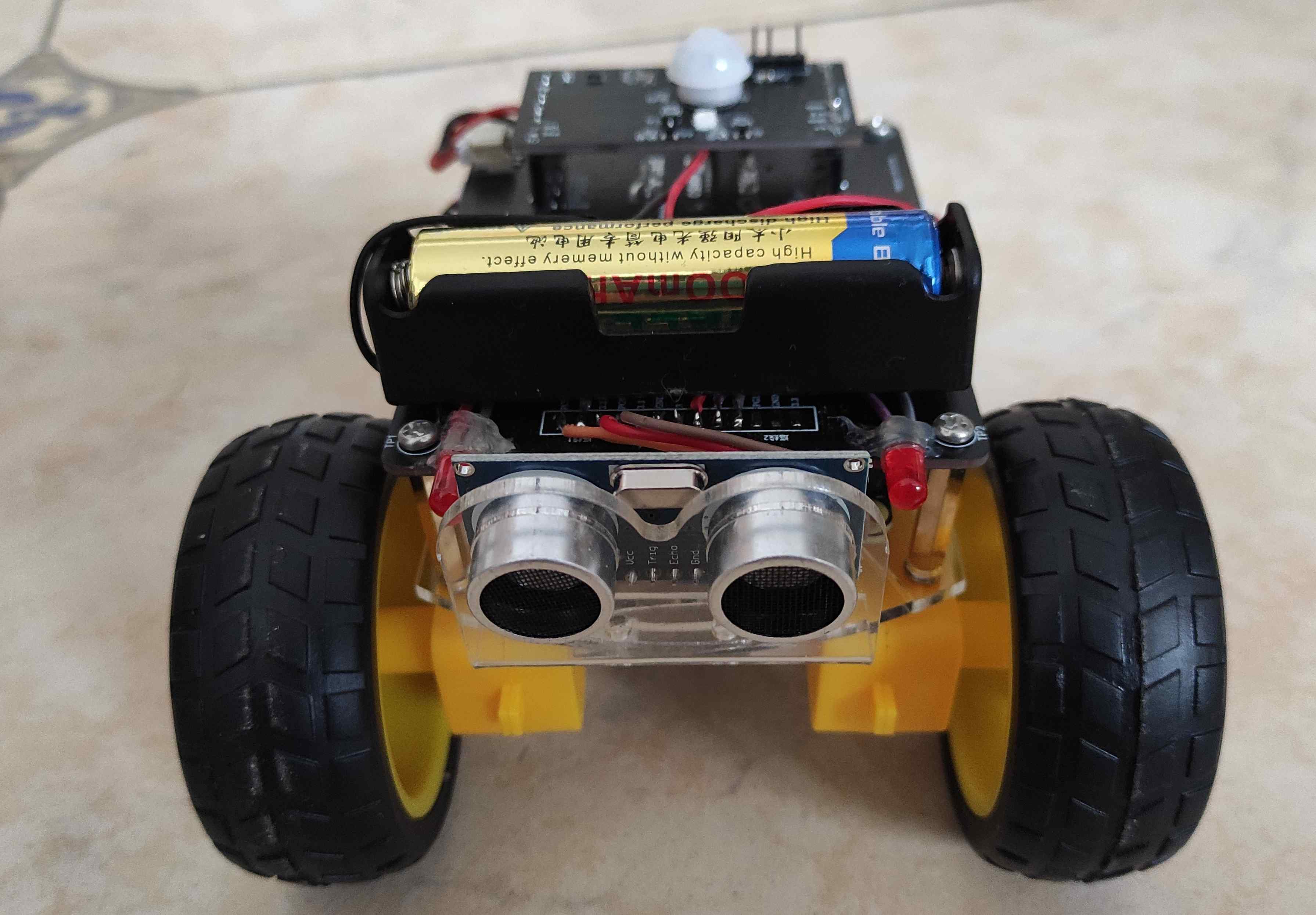

It’s the first time for a newbie to draw such a large board, and it’s very stressful!
The wiring is too complicated. I am a novice who can only draw two layers of boards. After two days of hard work over the weekend, I finally got something working!
Why is this little car said to have unlimited possibilities?
First of all, it is the standard configuration of a car: it includes four-wheel drive motor + ultrasonic + steering gear + two-way line patrol, and OV2640 camera interface!
Let’s talk about its extended functions: extended E53 standard interface, including SPI, IIC, UART, and 7 IO ports!
In addition, a solar charging circuit is connected!
Think about it: If I connect a standard ART-PI car, E53, with a temperature and humidity module and an air detection module, it will become an Internet of Things car;
If the harmful gas detection module is connected, it will be a harmful gas detection car, which can enter the unmanned environment to detect harmful gases;
If connected to an infrared device, it can also be a search and rescue vehicle, helping firefighters enter harsh environments to detect the presence of human bodies;
It also has a solar charging module, and when connected to a few solar panels, it becomes a solar car that never runs out of power;
Of course, you don’t need to connect to the car chassis. It is also an ART-PI IoT development board that can be connected to different E53 modules to achieve different application development scenarios;
Use your imagination! The possibilities for achieving it are endless...
The first E53 standard external board has been completed, connecting: infrared + human body + temperature and humidity + light + RGB light.
Infrared can be used to control the car, or it can be connected to RGB lights, and other sensors can be used to implement Internet of Things cases!
