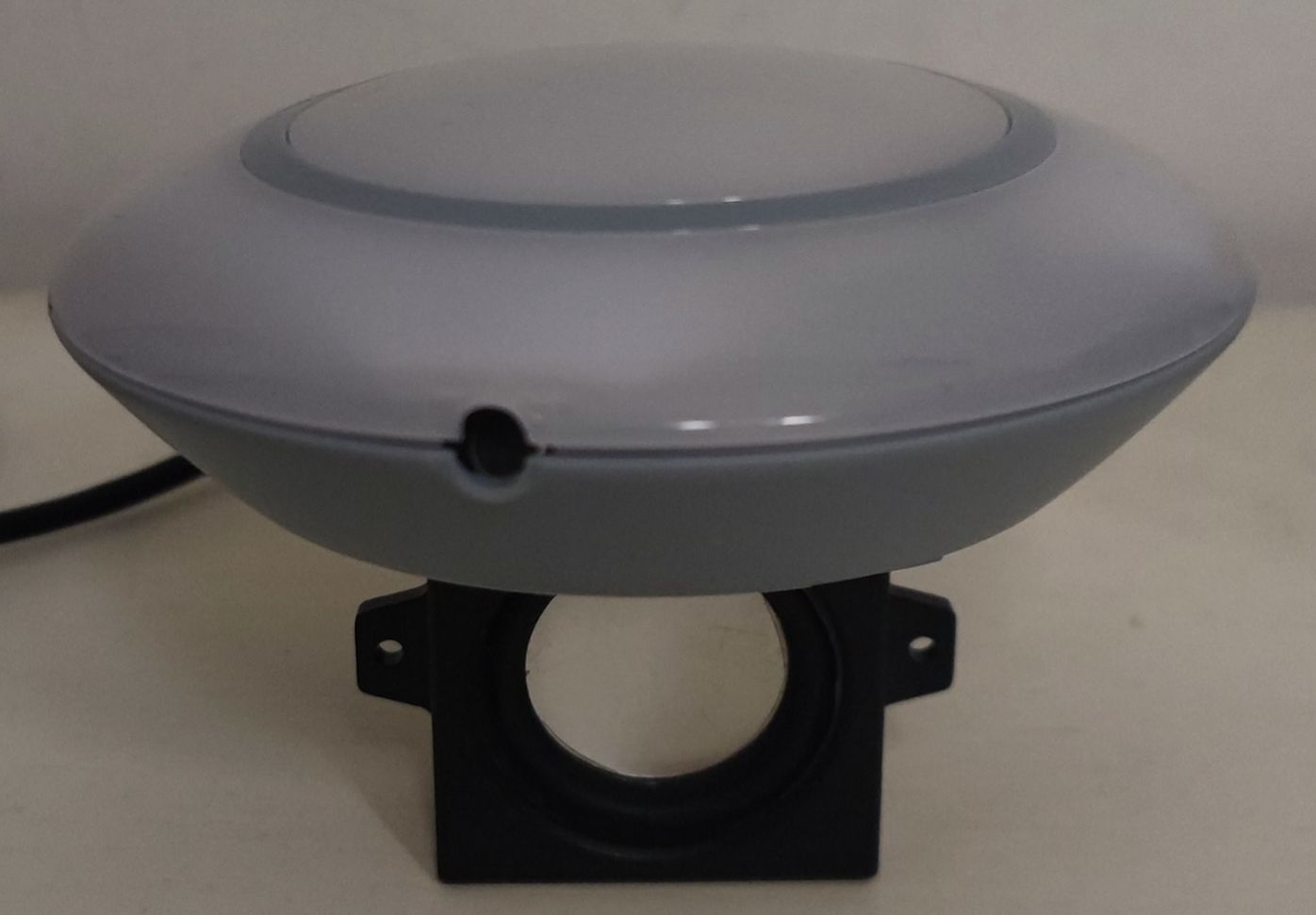

Then prepare a previous elliptical box,
Just put it on, haha, the pcb board is designed according to this.
Plug in the USB power supply and start debugging.
Perfectly completed, put a small speaker underneath, it looks like a flying saucer, named "UFO Graffiti Voice Remote Control"
Later, interfaces for voice chat and control of Tuya devices were added to the Tuya app.
