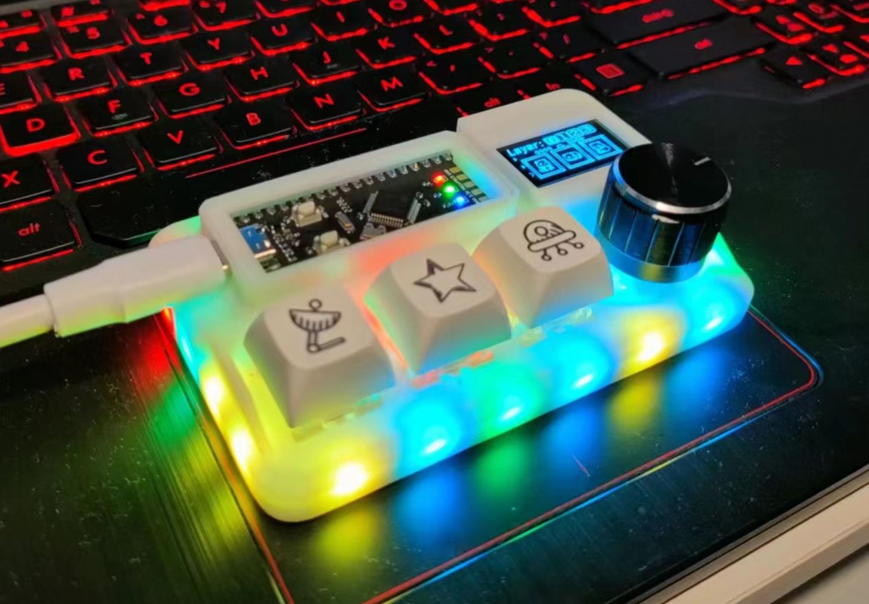

1. Finished product effect display
function demonstration can be viewed in the B station video: [DIY] Three-key + knob + OLED + RGB multi-function custom keypad
2. Material preparation
