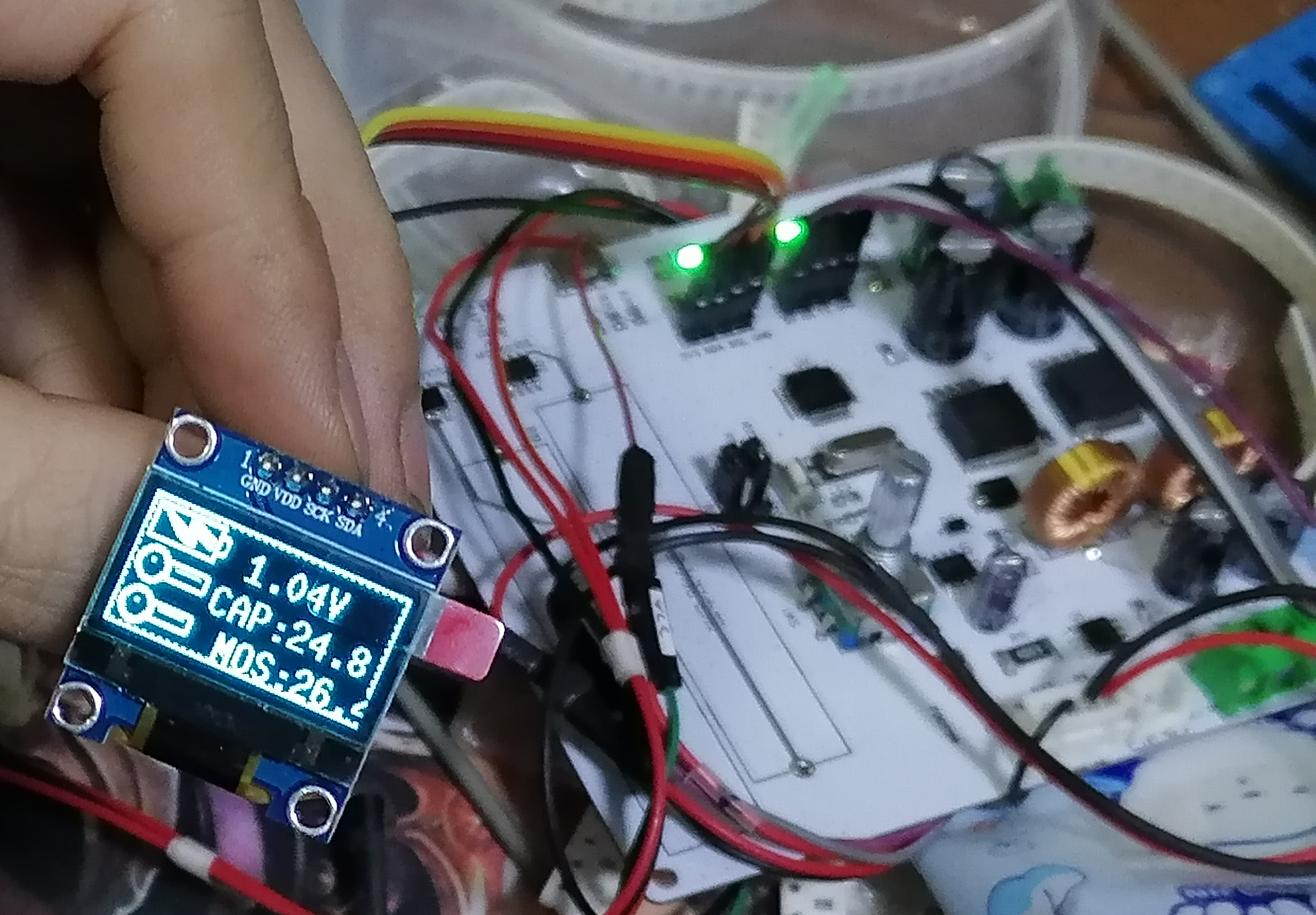

3.6 Display and control
The above is a rotary encoder circuit, which can be controlled by rotating left and right and clicking. The display uses 0.96-inch OLED interface I2C.
4. Physical picture
Display capacitor voltage, detect capacitor temperature, MOS tube temperature
Dynamic charging symbols will be displayed when charging, and the rotary encoder is used for menu selection and setting of various parameters.
