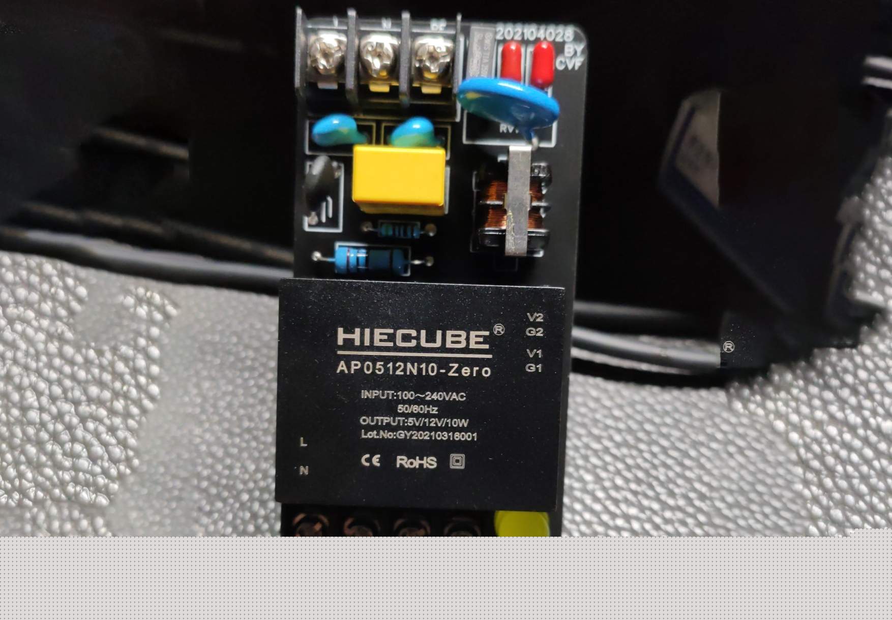

High energy cubic power board 220V to 12V 5V 10W
Because the power supply is 220V, but the microcontroller is 5V, the sensor requires 12V, and we don’t want to use a large switching power supply, so we made this module that can convert 220V AC into one channel of 5V and a channel of 12V. GND can be independent of each other. When a common GND is needed, the CGND pin short-circuit module can be used. It is a high-energy cube AP0512N10-ZERO with a power of 10W.
Most of the components inside come from the component packages that come with the module store, except for small resistors, LEDs and terminals.
Component package link: https://item.taobao.com/item.htm?spm=a1z09.2.0.0.7efd2e8dA1Rwa6&id=637380848303&_u=q22a3if4a39e
