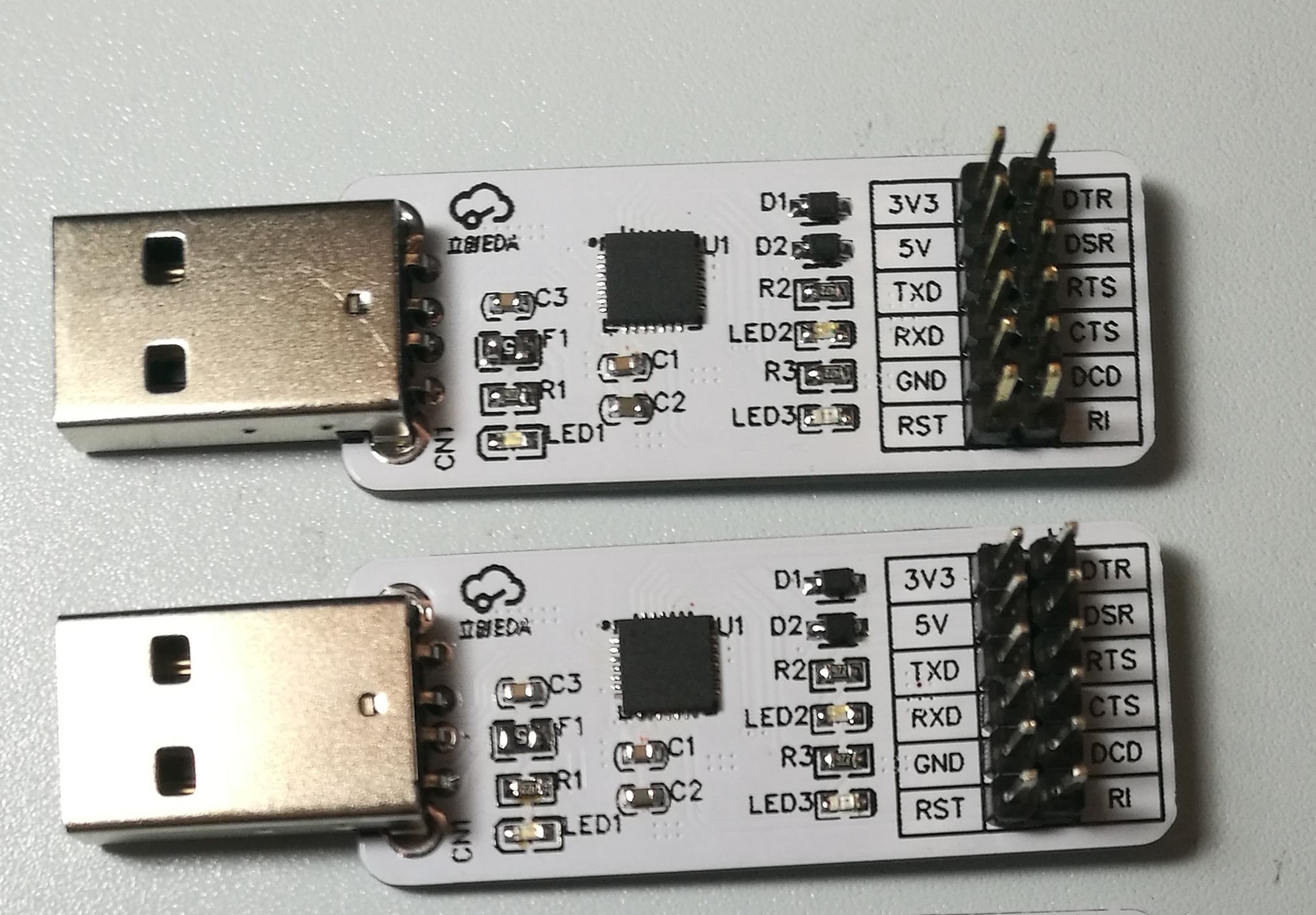

[Verified successfully] CP2102 USB to TTL solution verification board
CP2102 is a USB to serial port chip from SILICON LABS. This chip has a built-in 3.3V voltage regulator, simple peripheral circuit, and better stability than the CH340 series chips (of course the price is also higher)
  • Use the chip's internal 3.3V voltage regulator
  • Full IO extraction (mostly useful, but "full IO" is easier to pronounce)
  • 0.5A 0805 resettable fuse
  • TX/RX indicator light
  • 5V/3V3 output with diode protection
  • The bottom pad of the QFN chip is designed to reach the back for easy soldering! Updated on 2020/6/16, proofing & soldering completed, pictures have been added 8FF5DFDAB9C8ED6FFB890BAC98B73560.jpg704E583D01132A98FDFC5205710A2BD0.jpgCD38433B683D5835E03782073AC83848.jpg
