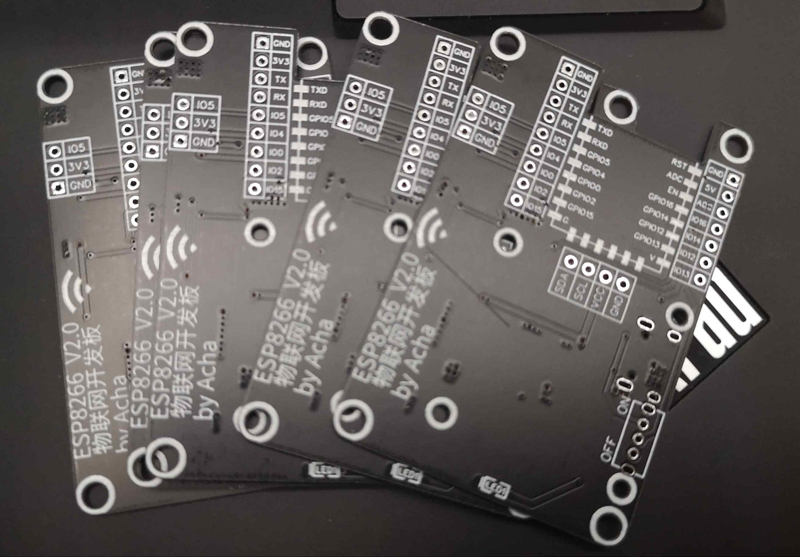

Based on the revision of the https://oshwhub.com/jixin003/iot_board_esp12 project, a Type-C interface is added to replace the original MINIUSB. DRC may report an error near the TypeC interface. This is a packaging problem and I can't help it.
The proofing boards are still in production and will be updated later~~~~
Digital Home: https://www.mydigit.cn/forum.php?mod=viewthread&tid=160016
Update: Added a Type-C resistor, connected the two D+D-pins of Type-C respectively (solve the problem of being unable to achieve both positive and negative dual plugging), and added a demonstration video
