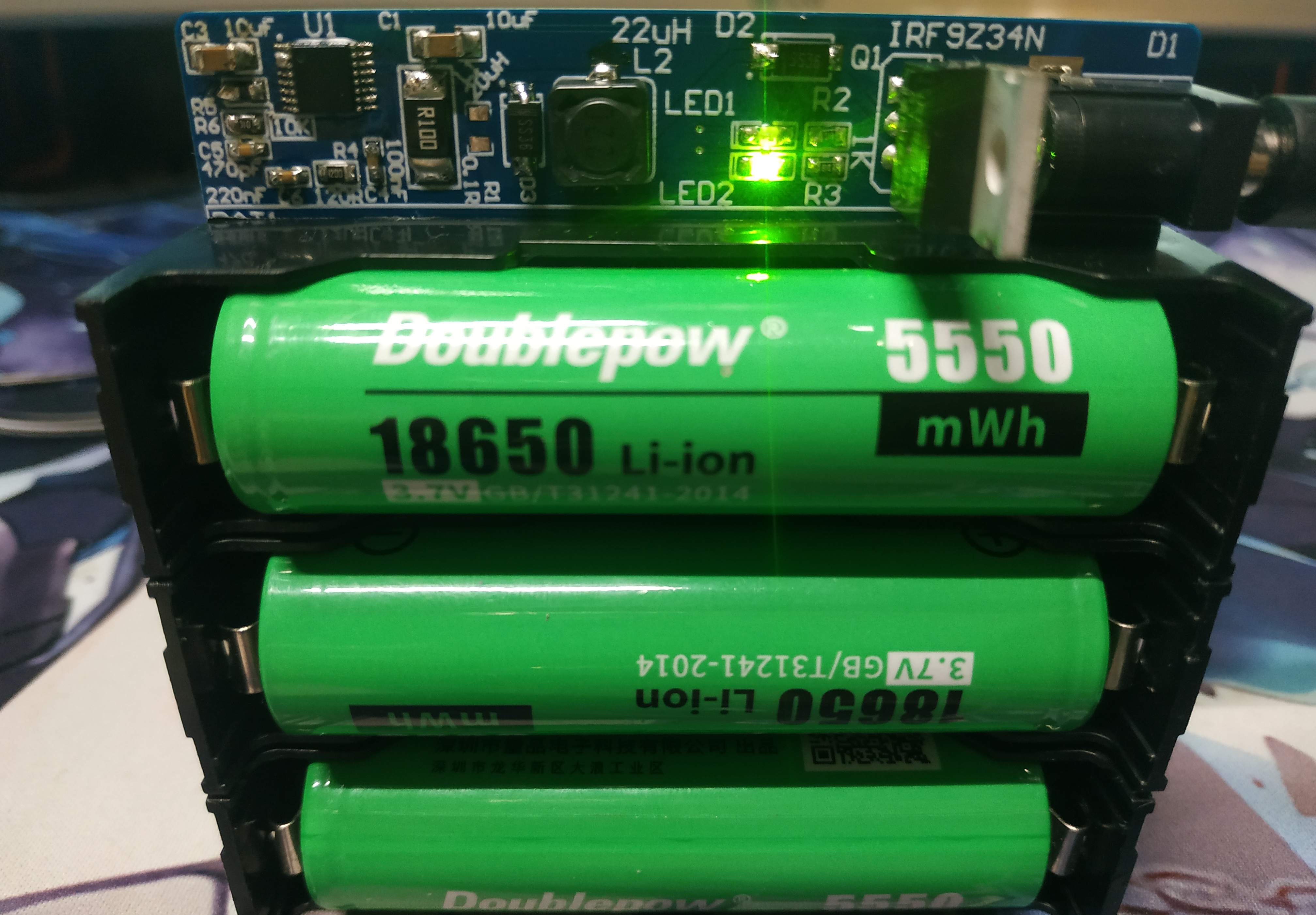

Detailed parameters and functions can be found in the data sheet. I will talk about the main functions based on my PCB here.
Temperature detection and enablement: R5 is a negative temperature coefficient SMD 0805 thermistor. The resistance is 10kΩ at normal temperature and 3.5kΩ at 50 degrees. This way the chip has high temperature protection.
If you are careful, you will find that if the resistance drops, charging will stop. If the TEMP pin is directly connected to GND, charging will stop. Then you can connect an N-channel MOS tube to R5 in parallel. Control the start and stop of charging. But I didn't do this function.
Selection of inductor and current sensing resistor: There is also a choice regarding the inductor. It is recommended to use power inductor L2 and the package is CDRH74. L1 is a chip inductor, not a power inductor. L1 is used in testing. In actual installation, L1 does not need to be installed with an inductor.

LED1 is the charging indicator light, it is recommended to install red
LED2 is a full power indicator light, it is recommended to install a green
When the battery is not installed or the charging voltage is insufficient, the two charging indicators will flash.
Q1: Finally Q1 is a P-channel MOS tube, I use IRF9Z34N
Note: The charging voltage must be greater than the battery voltage, otherwise it cannot be charged, and the two charging indicators will flash. The one I use is 15V. It is recommended to use a power supply greater than 15V for charging.
Advantages: fewer peripheral components, charging current up to 5A, battery temperature monitoring function
Disadvantages: The biggest disadvantage is that it needs to use a voltage above 12.6V for charging (however, the manual actually says 7.5V to 28V), because the IC is charged at a reduced voltage.
The picture above shows the twin LED lights flashing when the voltage is insufficient.
The picture above is a picture of charging completed when the voltage is 12.6V, and the charging completed indicator light is on.
