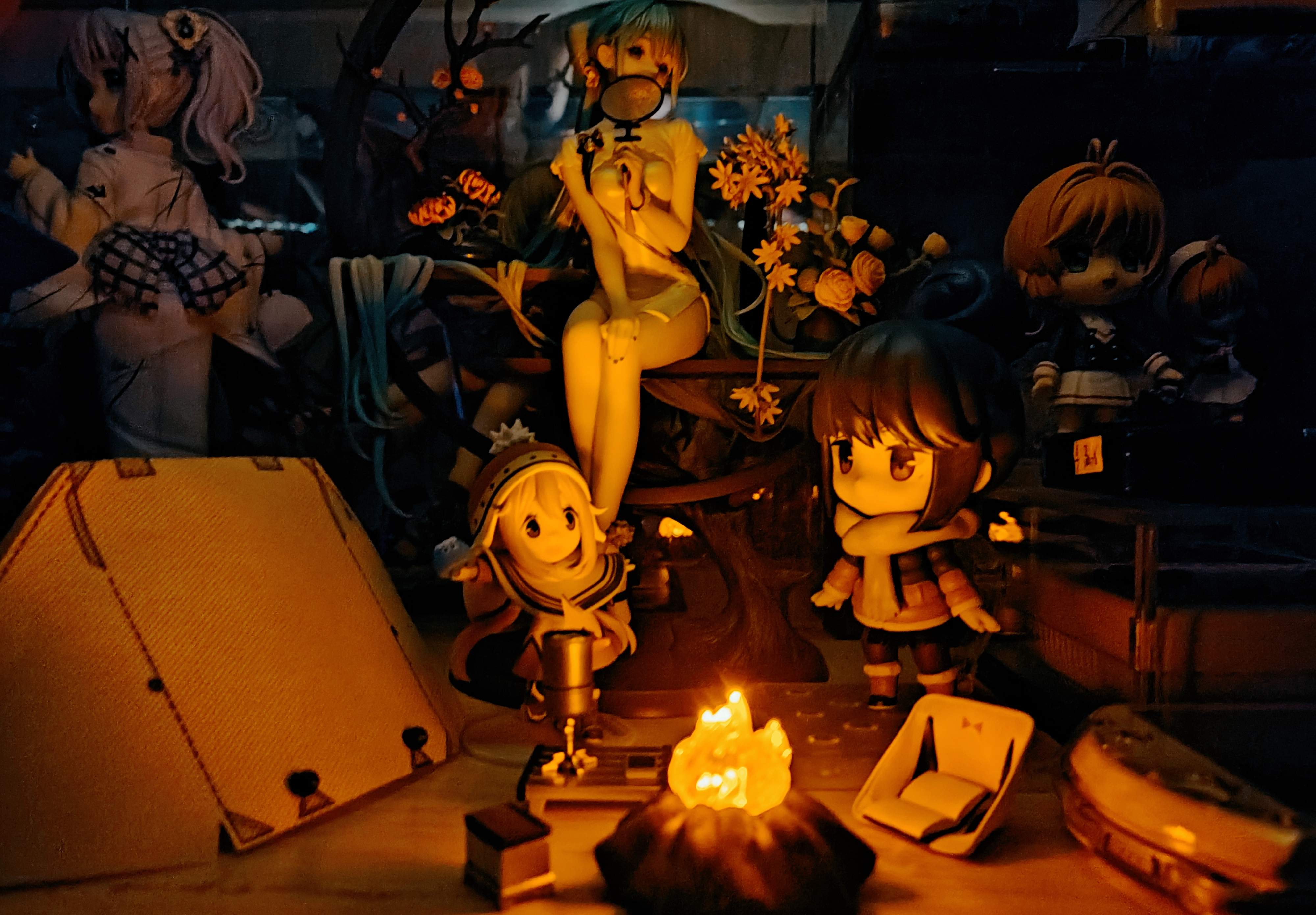

The thing is like this. At the beginning of 2021, I saw that GSC’s Shima Rin Nendoroid figure was reprinted on HPoi, so I quickly went to the HPoi official store to place an order, and received a repayment notice last month (October), and then I saw a comment on a certain website saying where this bonfire lamp came from, so I was curious and searched on Baidu. I found out that this bonfire lamp is a special item from the GSC Taobao official store. Woc, I didn’t know. I will buy it from the GSC official store in the future. Forget it, but this lamp is still almost 100 more expensive, and there are a lot of family heirlooms on a certain fish. Okay, raise the price, right? I’ll make one myself!
2. Introduction
Designed to replace GSC981-DX, the special campfire LED light of Shima Rin DX version, it uses ATMEGA13A-SU as the main control, built-in LTC4054 lithium battery charging circuit, supports 60 mAh battery, type-c charging port, and self-locking circuit.

5. Flame effect
See video effect.
There are 9 effects in 3 categories.
The first three are to simulate the flickering effect of a campfire, and the three flickering frequencies are different.
The middle three are fixed brightness and always on, which are 1/4, 1/2, and 1 brightness respectively.
The latter three are breathing light effects, the difference is the duration.
