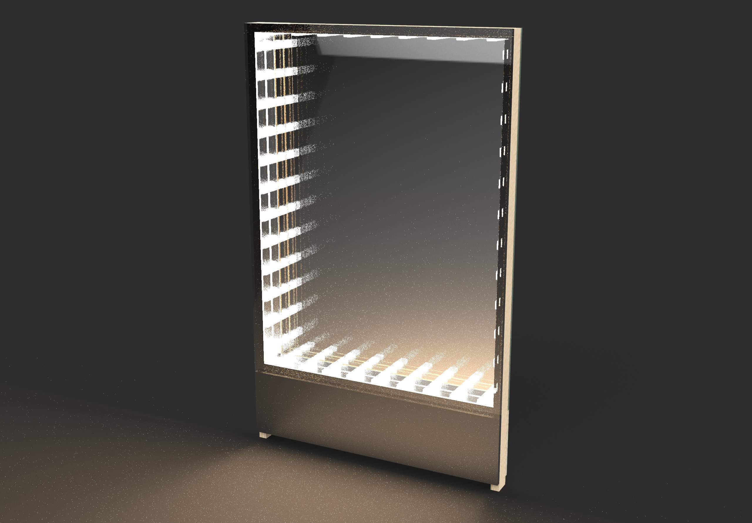

[Training Camp_Advanced Class] Internet of Things Infinite Space Bedside Lamp
prospect
I have a very beautiful bedside lamp at home . This time I want to learn knowledge through this competition training activity and transform this previous work into an Internet of Things device.

The frame of the casing of my lamp is made of wooden strips, and the place where the circuit is stored looks like this:
image-20200806144921324
As you can see, the thickness of the wooden frame with the type-c interface on the left is 5mm.
This means that I have to choose a longer type-c female socket, otherwise the male plug cannot be reached.
