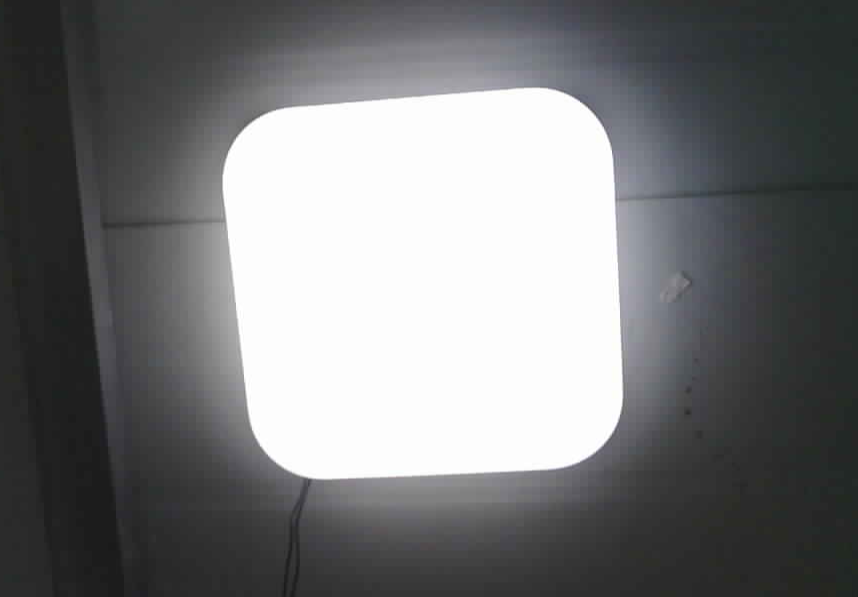

7 Welding debugging
First, solder the power supply and main control part, and power on for testing
Enter the network configuration mode and configure the network.
Weld the remaining parts
After measuring that there is no short circuit, install the magnetic screws, insert them into the ceiling lamp, power on and wipe the machine~
