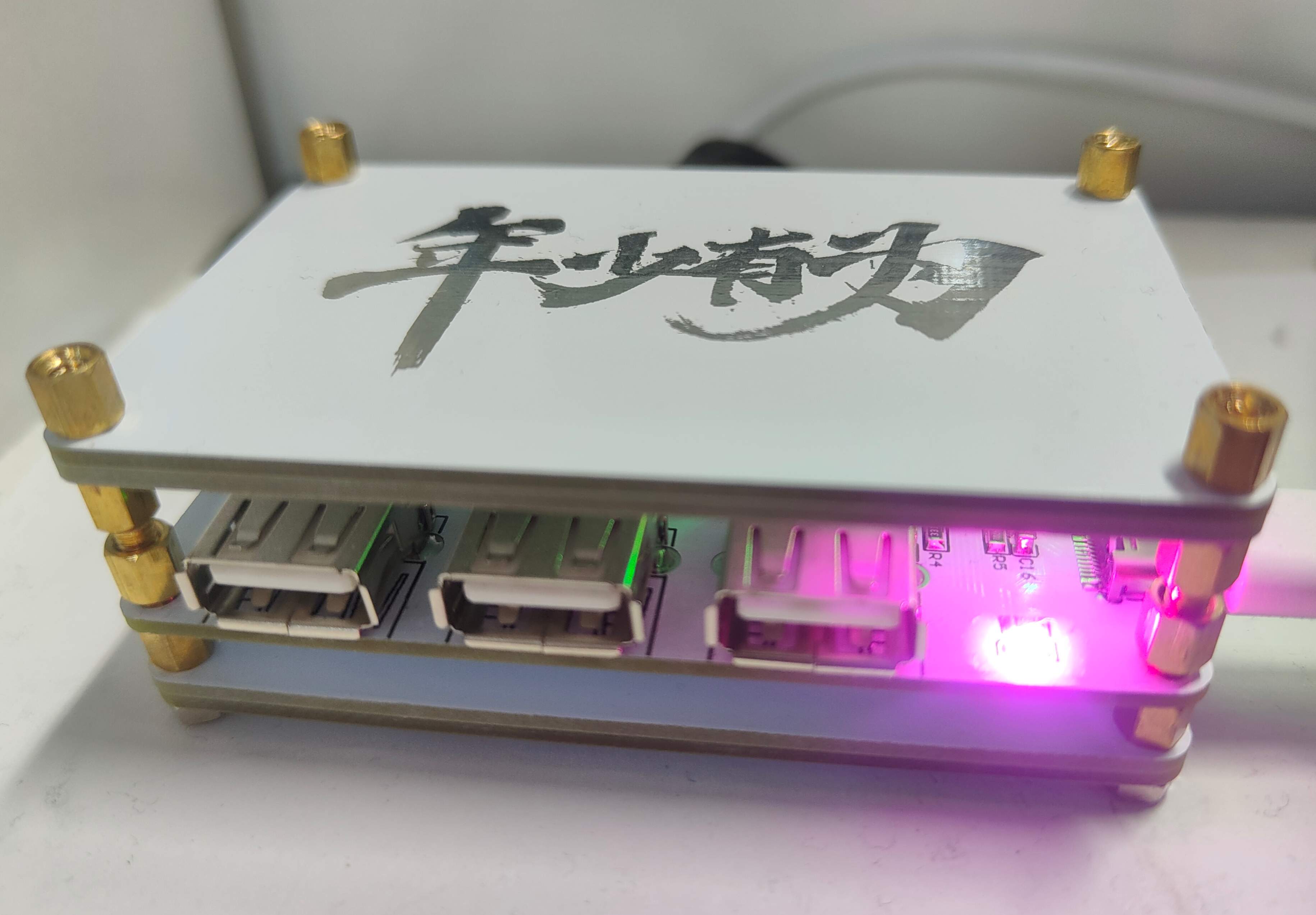

USB docking station based on MA8601
The USB docking station designed this time has two interfaces, Type-C and Mirco-USB, making it easy to use unused data cables to realize USB expansion functions.
In addition to the USB one-to-four function, the MA8601 chip also displays whether the USB device is recognized and uses LEDs to display it. The 4 interfaces correspond to 4 LEDs. In the picture above, the purple LED is the power indicator light.
In the picture above, the four on the right have USB functions, and the two on the left only have charging functions. Because there are many USB ports in daily use, two more charging ports are added. If they are not needed, they can be deleted directly.
The 4 LEDs in the upper right corner show the number of USB plugged in. 4 LEDs of different colors are used to increase the aesthetics of the docking station.
The attachments include the schematic diagram, PCB diagram of this project, and the decorative PCB board above. The silk screen in the attachment has not been deleted. Just delete it on the silk screen layer when using it.

The PCB picture picture this time is used to decorate the USB docking station. The picture below is the finished product.
The picture below is a 3D preview of the PCB:
The actual picture is as follows (the proof is white):
Principle: Copper is applied to both the front and back sides (without copper, the desired effect will not be achieved), and the picture is placed on the Top Solider and Bottom Solider layers , you can realize the display of pictures (text).
