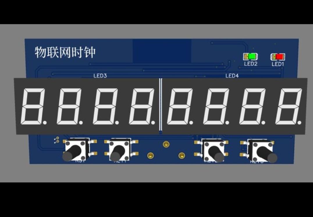

Project description: Use Essence esp-c3-12F wifi module to design an Internet of Things clock, equipped with real-time clock DS1302 chip and digital tube to design an Internet of Things clock
Function introduction and demonstration:
1. Automatically obtain network time through esp-c3-12FWiFi. Synchronize the time display on the digital tube
2. Use the DS1302 real-time clock chip to maintain the memory travel time. In order to ensure that the clock chip DS1302 can maintain the time memory travel time in the event of a power outage. Bring a button battery to the DS1302 so that the device can continue to run after power off, and use a 32.768KHz crystal oscillator to provide an accurate clock source to the chip.

2. The most difficult welding is the welding of the USB port. You need to be a little patient when welding here, otherwise the board will be easily scraped.
