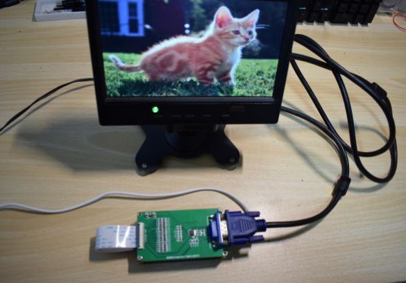

A cheap RGB to VGA adapter. You can make STM32 (or other MCU/MPU with LTDC controller) directly drive standard VGA display devices (not limited to monitors, but also TVs, projectors, etc.). Solve the problem of MCU screen not being big enough, not cool enough, not beautiful enough at once. Supports the RGB screen interface of Punctual Atom and Wildfire.

Picture appreciation
Empty board
Welded finished product
Punctual Atomic F767 core board successfully driven
Used as an adapter board for Punctual Atom and Wildfire Screen
The screen in the picture is atomic. After using this module to transfer it, it can be used on Yehuo's development board. image.png
Show picture effect
The development board is installed under the module, and the model is Wildfire F429V1 (again, this model is not recommended) image.png
