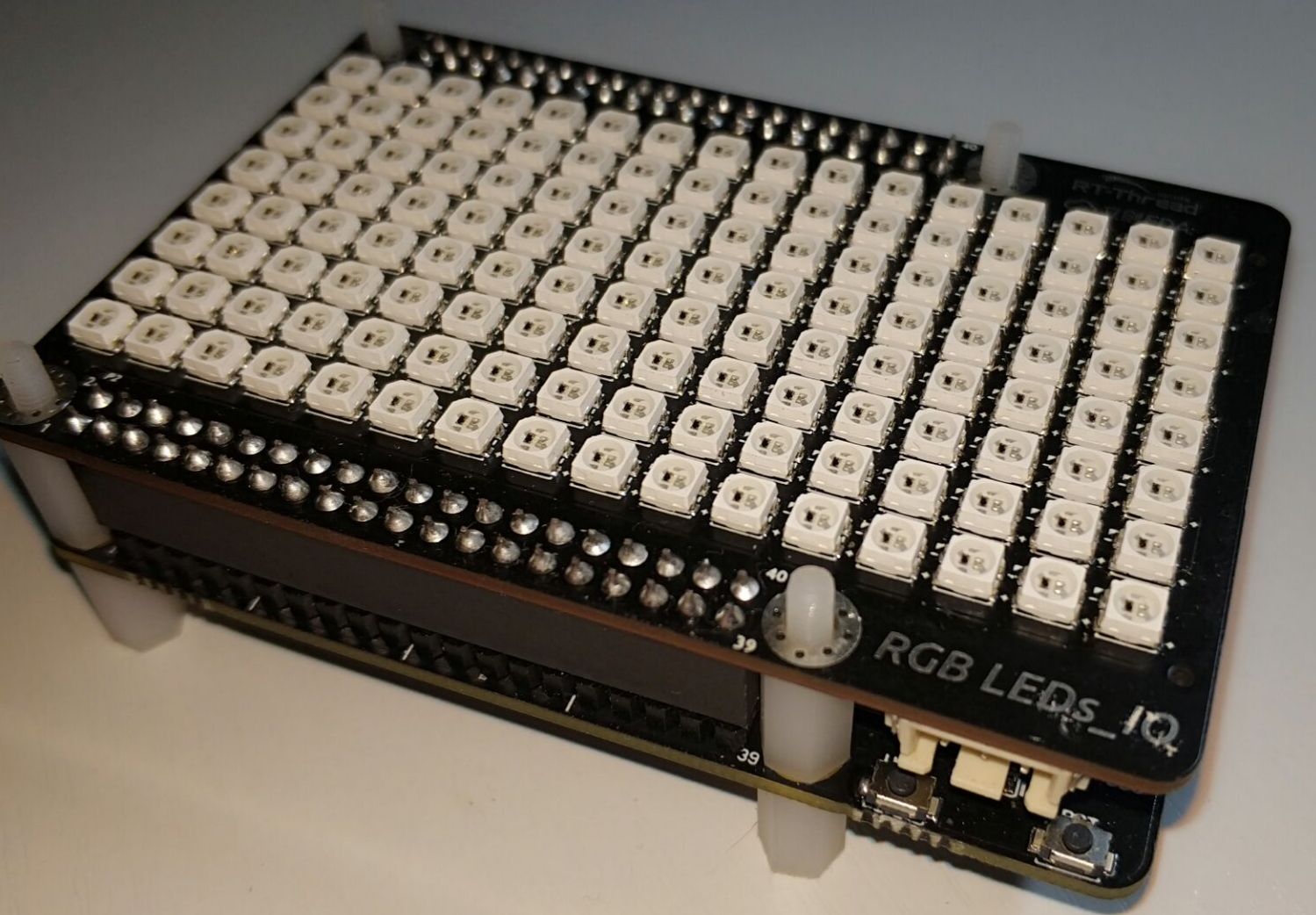

2. Project Introduction
RGB LEDs_IO is a full-color LED dot matrix expansion board built for ART-PI open source hardware. It adopts ART-PI standard PCB size and can be stacked with ART-PI.
Onboard resources
  • Onboard 128 WS2812B-Mini-V3 intelligent external control integrated LED light sources;
  • A 4-bit DIP switch is used to switch the control pin of ART-PI;
  • One RTC backup CR1220-2 horizontal battery holder;
  • Two horizontal patch XH2.54-3P connectors are used for cascading .
  • Two 2*20P-2.54 straight plug headers (

6. PCB design
The PCB design of this project focuses on the array layout of 128PCS WS2812 lamp beads. Below is a picture of the array with the completed layout.
