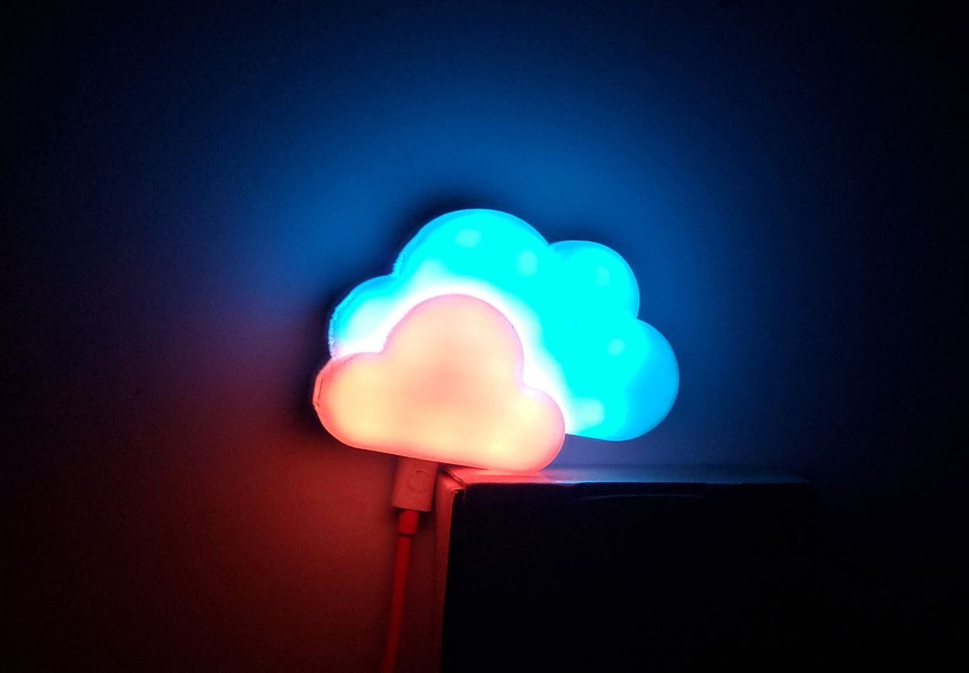

  1. Home temperature and humidity monitor based on Tuya Smart
  2. Through the different colors of lamp beads and various changes, the indoor and outdoor temperature and humidity conditions are dynamically displayed.
  3. You can also remotely check indoor temperature and humidity through your mobile phone
  4. Can be used as home decoration
  5. Big clouds represent the outdoors and small clouds represent the indoors.
  6. There are still many ways to play with lamp beads, such as atmosphere and night light.

The most basic Internet connection has been completed, and the automatic wifi network distribution is very good. I don’t have SHT30 yet, so I can only use random numbers for the time being.
210125
The remote weather data has been obtained. The components have been received. Now we just need the PCB.
210128
9b909d4477287fdfdf1f7a1e7b10c614_w3449_h2304_s2168.jpg381b60c60bfe882bc1efee920984330d_w4096_h2304_s1723.jpgScreenshot 31-01-2021 14.27.01.png
210131
The project is basically completed and the process has been smoothed out, but there are still some improvements that need to be made: The sensor needs to be connected externally and away from the heat source to achieve better results.
