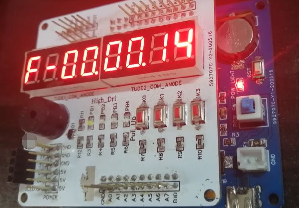

I have been learning STM32 recently and want to make an STM32 system board that can be used to debug programs. In order to add peripherals, I have designed an expansion board that can be plugged directly into the system board. The design of the expansion board can be changed according to different debugging equipment, and the system board does not need to be redesigned, which improves the utilization of the system board.

【expanding board】
Expansion board schematic diagram: image.png
The expansion board uses a female header with extended pin headers to connect directly to the system board.
An eight-bit common anode digital tube is designed, using 8 IO ports to connect triodes, which occupies a lot of IO ports. When the number of IO ports is insufficient, the 74HC595 displacement buffer can be considered for design;
a passive buzzer;
Four LED indicators (high level drive);
Four buttons (pull-up);
OLED's 4-pin interface can be directly plugged into a 4-pin OLED.
Except for the pins used by these peripherals, the remaining pins are led out with long rows of pins to facilitate the connection of other peripherals. _EIEITLLZU%VH13)LN0SVKC.png
