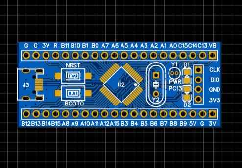

BluePill
LQFP-48 packaged STM32/GD32/AT32 development boards, including but not limited to the following models:
  • STM32F103C8T6
  • STM32F030C8T6
  • GD32F103C8T6
  • GD32F130C8T6
  • GD32F150C8T6
  • GD32F330C8T6
  • GD32E103C8T6
  • GD32E230C8T6
  • GD32VF103C8T6
  • AT32F415CBT7
  • AT32F413CBT7
  • AT32F421C8T7
The pin arrangements of these models are compatible and can all use this development board.
Compared with other versions on the market, the improvements are as follows:
  • USB replaced with direct plug MicroUSB, strong and durable
  • The BOOT0 selection is changed to a button. Press and hold BOOT0 and then press NRST to enter the built-in Bootloader.
  • The 32.768 crystal oscillator is replaced with a 3x8 package and is not soldered by default.
  • The VBAT pin uses a 0R resistor to connect to the onboard 3.3V power supply
  • The SWD interface sequence is changed to CLK, DIO, GND, 3V3
