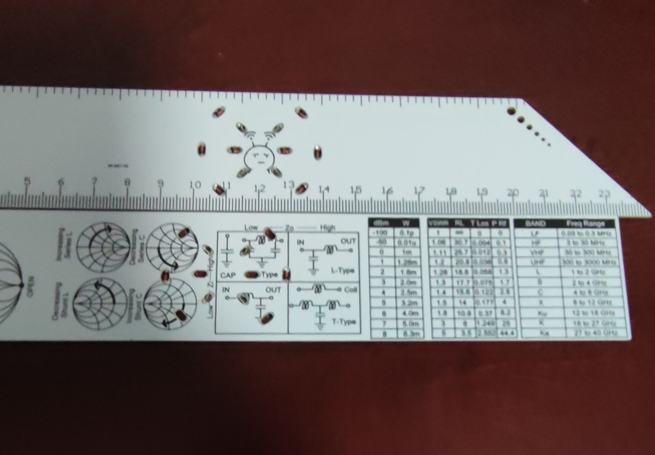

The LED display includes two parts: a. the loop where 1N60 is located; b. the loop where the two LEDs are located
The slotted hole is cut in the middle with a carving knife and used as a soldering pad. The parts that are not to be welded do not need to be cut. In actual testing, only two detectors can be welded and it can still work~
lceda may be garbled, the geber file has been packaged
use:
Radio frequency indication, the light will only turn on when the power is above 2W, such as a walkie-talkie;
Wireless indication, NFC and RFID are both available. If charging wirelessly, don’t be too close or the light will explode.
I drew it casually, it’s very lj, yes, right, that’s right, that’s it
bty: Please use 1.6mm thickness for proofing. If the trough edge with a 45-degree angle can be made, you can assemble a right-angle ruler.
