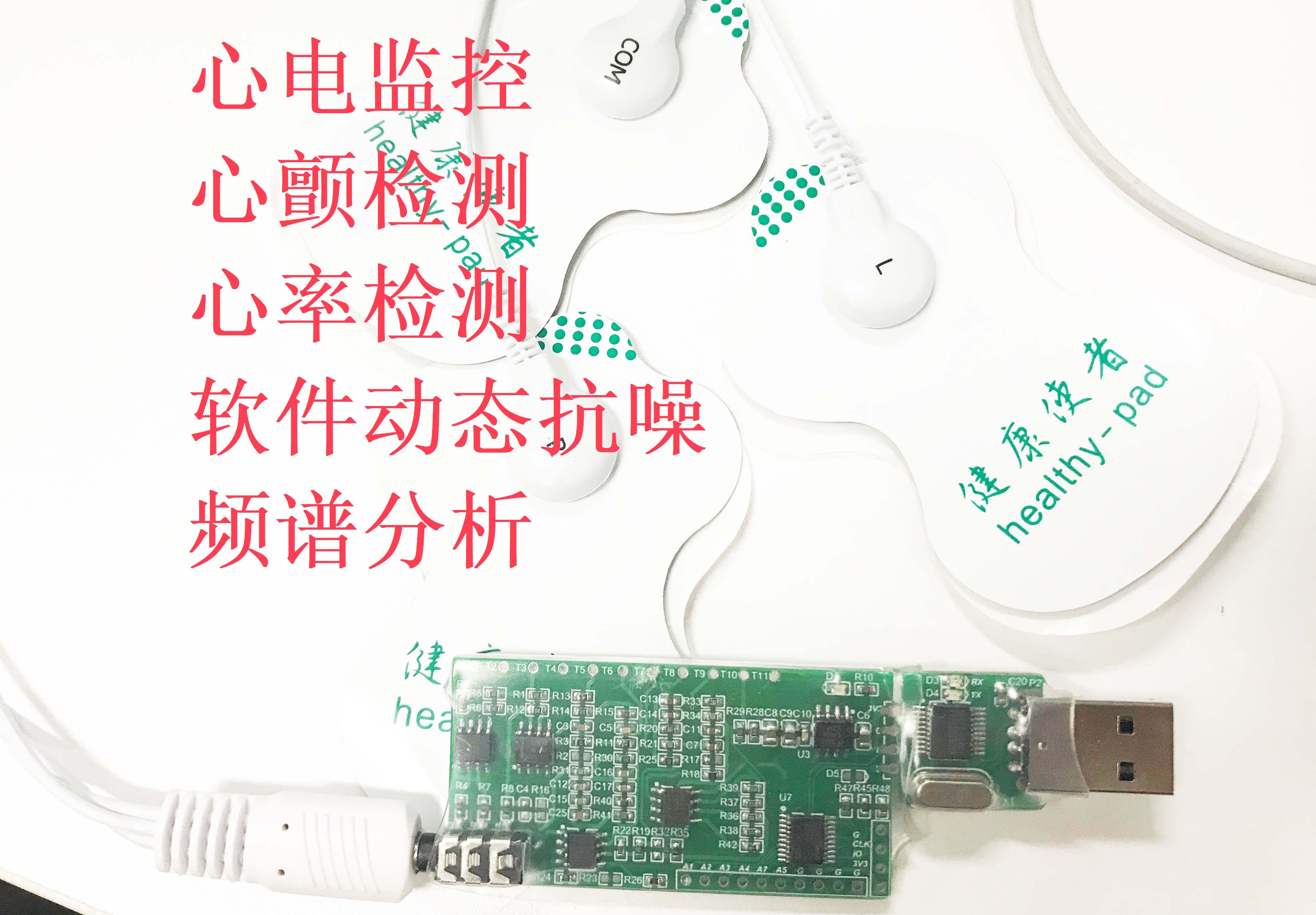

The hardware part of this project uses GD32F130F8P6 as the main control to provide the function of collecting data and uploading it. Use operational amplifiers to build various amplification/filter trap circuits to extract the three-lead ECG signals and filter out common interference. The USB to serial port chip is used to solve the communication problem between the MCU serial port and the host computer. The following is a general block diagram of the hardware structure: Hardware processing block diagram.jpg

Our initial plan was to use the AD8232 chip to extract ECG signals. However, after testing, we found that both our test circuit and the DEMO board we bought can only maintain good work in an interference-free state (turn off all AC appliances in the room). ), the anti-interference performance is extremely poor. The picture below is a typical waveform. This is the output waveform when we turn off all electrical appliances and turn on only one desk lamp (testing the AD8232 red module bought on Taobao): As you 50Hz interference.jpg can see in the picture above, there is a very high amplitude We analyze that the 50Hz power frequency noise is due to the insufficient driving capability of the feedback from the right leg and internal design reasons. Of course, if it is pure 50Hz interference, we can achieve it through post-stage filtering. After consulting the datasheet and practice, we found that due to the internal design reasons of AD8232, when the 50Hz interference reaches a certain level, oscillation will be caused: Oscillation waveform.jpg
Considering that our project will need to work in a more complex environment in the future, such as being applied to an electric defibrillation environment, which requires high anti-interference performance and flexibility guarantee, we chose to use discrete operational amplifiers to build our own small signal extraction circuit:Signal acquisition circuit.png
< br> After testing, the anti-interference performance is much stronger than AD8232. The conditions for our test are that air conditioners, induction cookers and other relatively high-power equipment are fully turned on. The picture below is the test report saved by the oscilloscope:
The 50Hz power frequency interference is almost completely filtered out, leaving only the 100KHz switching noise that is easy to process (it is too different from the operating frequency, so no need to process).
