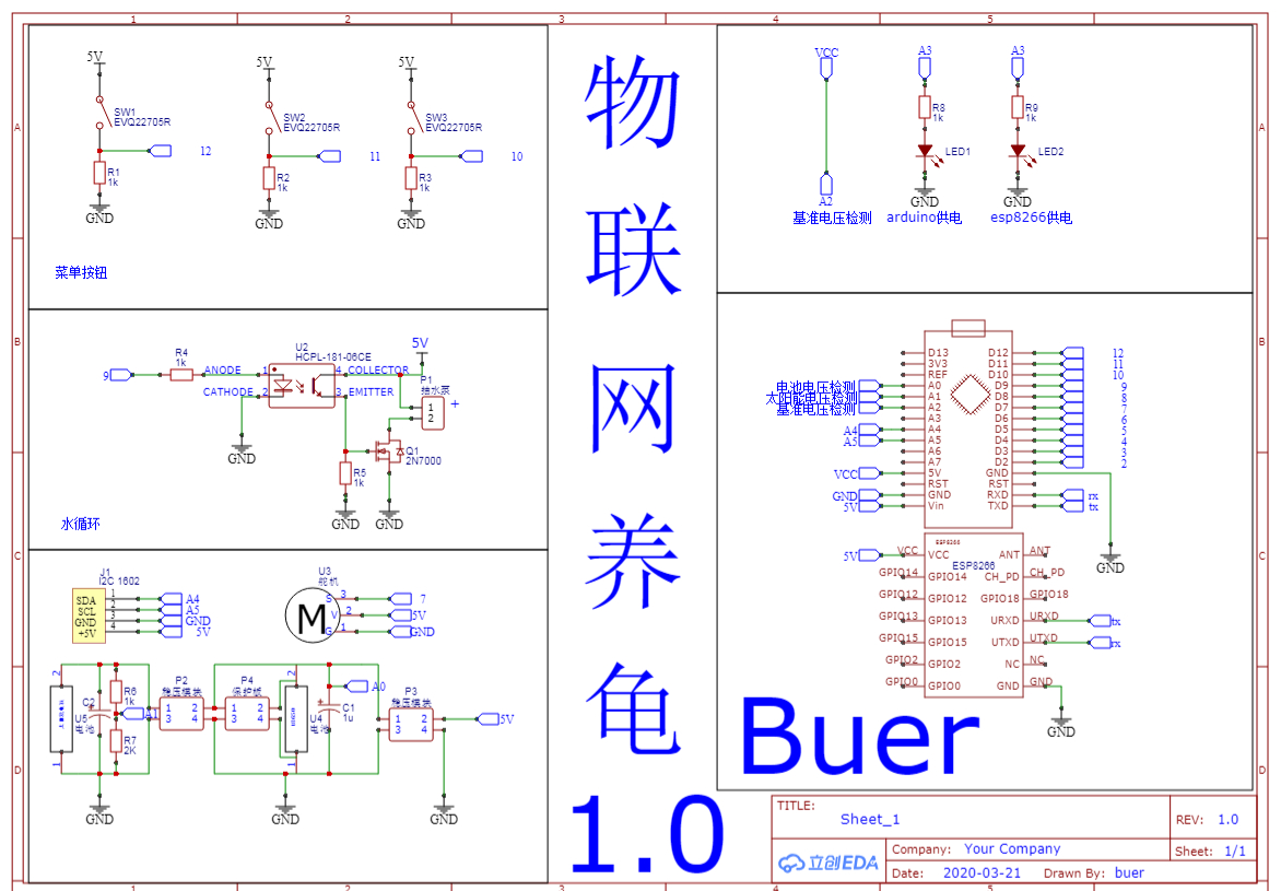

Using esp8266 and arduino nano for serial communication, it can control functions such as water circulation and feeding, and at the same time return water temperature, water depth and other parameters to the blikne platform. All arduino pins are lead out, and you can design expansion circuits according to your own needs. The power supply adopts dual power supply of solar energy and battery, which can switch the energy supply. With the sleep mode of 8266, the operating current can be as low as 20ma. 3w solar energy is enough to continuously supply energy.
