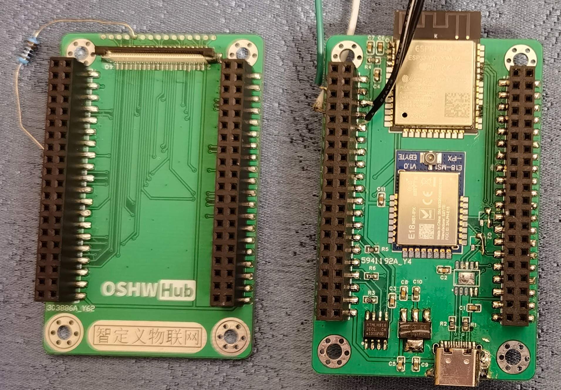

The smart home central control screen based on Liangshan School (GD32F450) can automatically obtain/display time, display sensor status information, and can also draw points, lines, rectangles, circles, and display pictures.
Onboard resources:
1. ESP32-WROOM: Connect to the network and connect to the smart home platform (homeassistion) through the MQTT protocol to achieve device status information acquisition and control
2. E18-MS1-ipx: Flash router firmware for extending zigbee signals Coverage, you can choose to connect the zigbee module serial port to GD32 or CH342 chip output
3 through Q1 and Q2 jumpers. CH342: USB to serial port module, supports two serial ports, one is connected to ESP32 serial port 0, and the other can be connected to zigbee through jumpers module.
Structural block diagram:
Demonstration: (The attachment contains a demonstration video)
About jumpers: The burner interface is broken, so solder the wires directly to the motherboard
