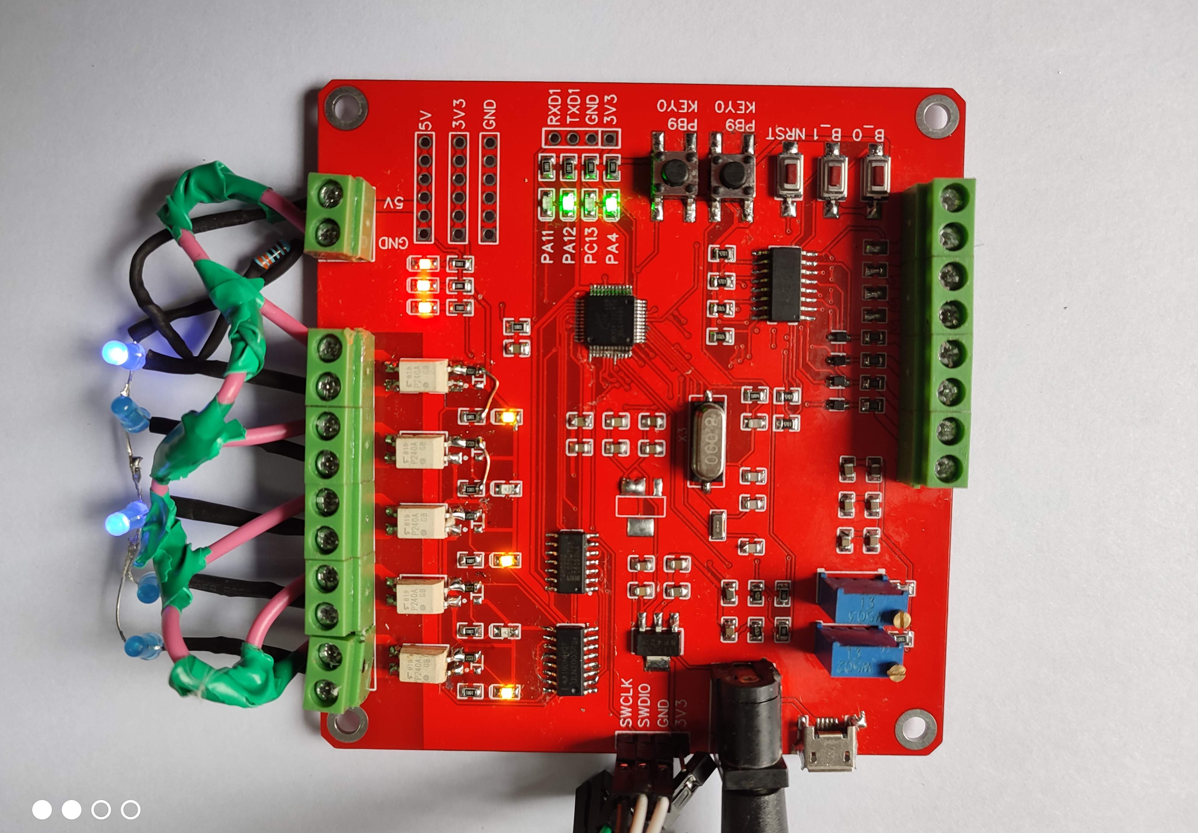

project description
  • Using HK32F103C8T6 as the main control MCU
  • With 5 channels of photoelectric relay output, the relay output has a light display
  • With 4 isolated switch inputs and 2 modulus inputs
  • BOOT button to avoid troublesome jumpers
  • 2 on-board buttons
  • 4 LED indicators
  • Can use DAP-Link and serial port download program
    • Thanks to Chuangxin Workshop for providing PWLink emulator support

design record
>The current version is V1.0
  • V1.0 known issues
    • Use of Linear Regulators
      • If the power supply is 5V
        • The 5V linear regulator located in the center of the board needs to be removed and its input and output shorted
    • The distance between the crystal oscillator and the MCU is too far. Although it does not affect the use, it is not standardized enough.
    • The photoelectric relay part lacks a current limiting resistor, causing the Darlington transistor to overheat. This can be solved by clearing the wiring and using flying wires.
      • Traces that need to be cleared (pink part)
      • Flying lead position (resistance 2K)
  • V1.1
    • Modify the problem of V1.0 and it can be used normally without cutting the wiring.
    • Update the corresponding wiring diagram
