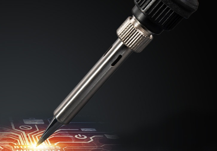

#The 4th Innovation Competition#AI Constant Temperature Soldering Iron
Brief introduction:
A portable intelligent constant temperature electric soldering iron based on touch sensing + single-chip microcomputer control. It is easy to carry, intelligently controlled, the soldering iron core and the soldering iron tip will never dry burn, energy-saving and environmentally friendly, and the service life of the soldering iron tip and the soldering iron core is more than doubled.
1. Detailed description:
   The touch + intelligent control is built into the handle of the electric soldering iron. When the user picks up the electric soldering iron, it switches to the high-power fast-heating constant temperature mode. When the user puts down the electric soldering iron, it switches to the low-power heat preservation energy-saving mode. The soldering iron core and the soldering iron tip are free from dry burning and save electricity, which prolongs the service life of the electric soldering iron. The service life of the ordinary electric soldering iron core and the soldering iron tip is about 3 months, and the service life of the AI ​​constant temperature electric soldering iron tip and the soldering iron core is more than 6 months.
2. Challenges faced and problems solved;
A. Challenges faced: 1. How to build the sensing circuit, single-chip microcomputer, and power supply chip into the handle of the electric soldering iron. 2. How to quickly heat up from idle state to use state. 3. How to reliably identify the user status.
B. Problems to be solved: People who use electric soldering irons (or electric soldering stations) are divided into R&D engineers, debugging engineers, maintenance engineers and electrical maintenance personnel, technical workers on the production line and beginner electronic technicians. 1. When R&D engineers and debugging engineers debug circuit boards, they may use electric soldering irons for a few hours, and the soldering iron is in a waiting state 80% of the time. Because: a. Engineers will not and cannot wait until they need to use the electric soldering iron to plug in the electric soldering iron, and it takes 3-5 minutes to preheat the electric soldering iron. b. If the electric soldering iron (or electric soldering station) is plugged in for a long time, the electric soldering iron tip and the soldering iron core will dry burn, and the inflated dry burning soldering iron tip will be very dirty, and the dirty soldering iron tip will seriously affect the welding quality. 2. Maintenance engineers and electrical maintenance personnel use electric soldering irons or electric soldering stations at different times due to different measurement and analysis times. The electric soldering iron (or electric soldering station) is dry burning 80% of the time. In addition, it is very inconvenient for a maintenance worker to carry a 2-3 kg large soldering station. 3. Beginner electronic technicians, due to the high price of soldering stations, buy ordinary electric soldering irons without constant temperature function. Without constant temperature control, the electric soldering iron will burn out in 2-3 months, and the temperature of the electric soldering iron is high, and the welding quality is not guaranteed. This AI constant temperature electric soldering iron has constant temperature and intelligent sensing control, is easy to carry (the size of an ordinary electric soldering iron), and the price is almost the same as an ordinary constant temperature electric soldering iron.
3. Key points of hardware and software:
A. Hardware:
1. How to install the power chip, touch chip, single-chip microcomputer and other hardware into a small soldering iron handle with a good feel (the large handle feels very bad, and no one uses it now): The power chip uses the KP3310 SOP8 of Biyi Technology, and there are only 5 peripheral components; the touch chip uses the dedicated touch chip SC01, SOP8 package, and the single-chip microcomputer uses Songhan or Zhongwei 12-bit ADC12 SOP8 package, and the above configuration components can be built into the handle.
2. Soldering iron core: The selection requirements of the soldering iron core are that in low-power insulation mode, the power is 8-10W, and in high-power working mode, the temperature is required to rise quickly to about 350 degrees within 3 seconds, and the temperature is constant. In this way, a ceramic 4-wire heating core with a built-in temperature-sensitive resistor is selected, the temperature-sensitive resistor is 45-55 ohms, and the heating resistor is a 90W ceramic heating core. However, how to maintain a constant temperature for such a high-power heating core.
3. Induction mode: Due to the use of 220V or 110V voltage, the touch sensor (point) cannot be placed externally and must be in the handle for safety. At the same time, due to the huge differences in the user's hand grip, how to ensure reliable touch sensing. This design uses a dedicated touch chip SC01, + spring close to the inner shell of the handle,
B. Software:
1. The heating part of the soldering iron core is about 20mm away from the soldering nozzle. The soldering iron core temperature-sensitive resistor detects the temperature of the soldering iron core, not the temperature of the soldering nozzle. The software adopts full-speed heating first, and then delays for a certain period of time, and then gradually reduces the input power.
2. Environmental influence. Under the same power, the temperature of the soldering iron tip is very different when the environment is 10 degrees and 36 degrees. At present, the single-chip microcomputer is used to detect the ambient temperature. When the soldering iron is working, the influence of low ambient temperature is compensated.
