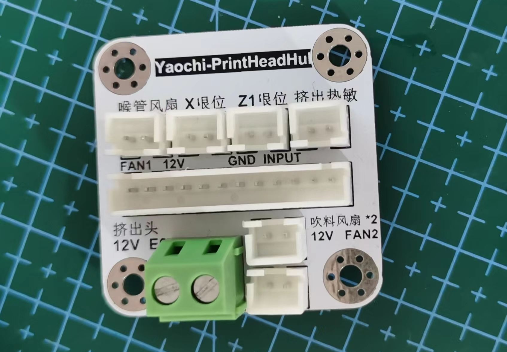

  It can be installed on the back of the process extruder and connected to the main board through a drag chain cable, which is simple and beautiful.
  You can also buy a 10cm 12P XH2.54 cable to connect to the motherboard instead of using a drag chain cable.
  The PCB is in the attachment.
The BOM is 6 2P and 1 12P XH2.54 straight pin sockets, and one 5.08 pitch binding post. As shown in the picture, it is easy to see at a glance.
