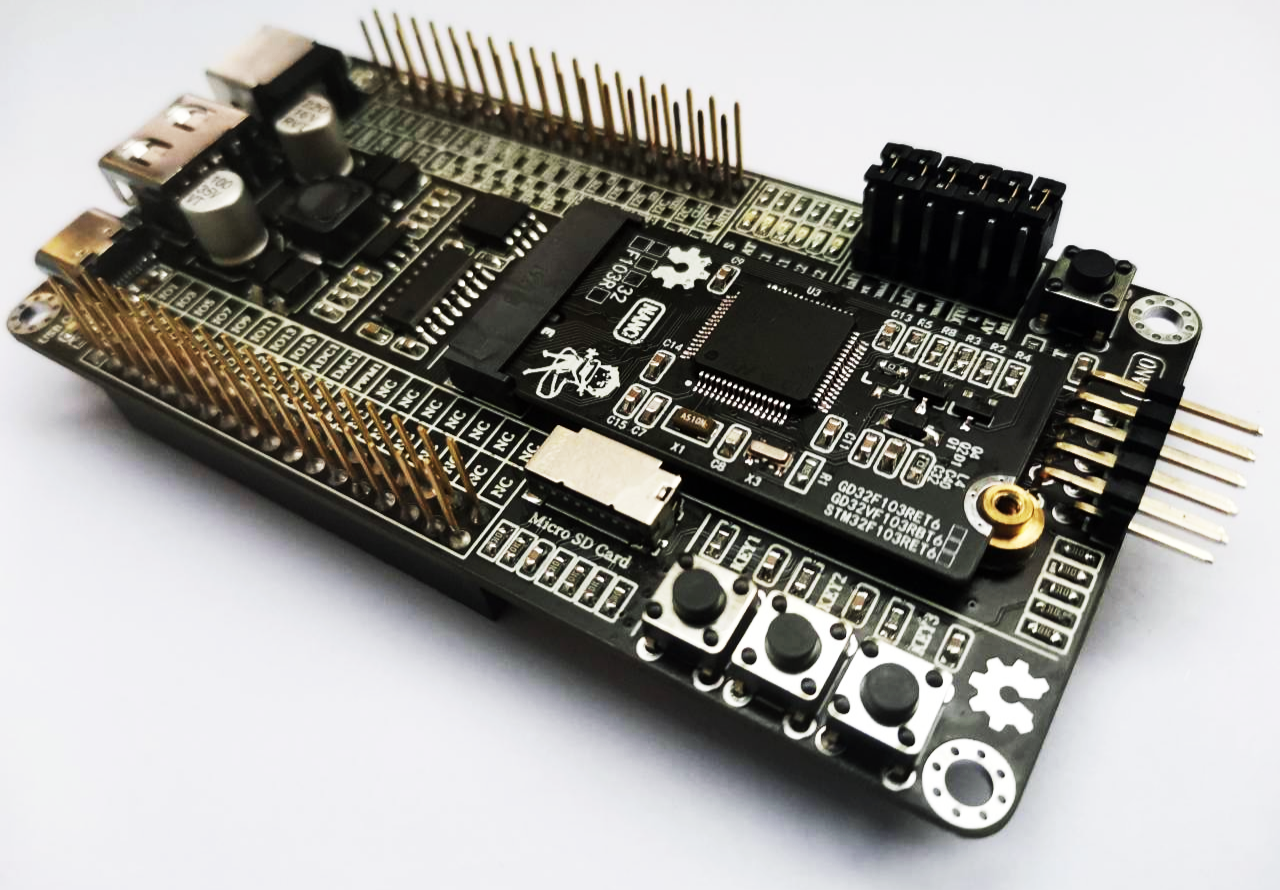

【20201117 Update】NANO development board-carrier board
Introduction
"XBoard NANO development board" is a series of development boards with different main controls (100pin and smaller microcontrollers) but consistent appearance and pin functions. The main purpose of this series of development boards is inter-board communication protocol testing (development board + development board) , Single module test (development board + evaluation board)
"XBoard NANO Development Board" consists of a carrier board and a core board, which are connected through the M2 E Key interface. This project is the carrier board part of the "XBoard NANO Development Board".
Some core boards:
This series of development boards are not pin-compatible with the front-end series "XBoard Standard Development Board" (obsolete)
On-board resources
12V power input/output pin
5.0 power supply (maximum current 2A) input/output pin
3.3 Power input (maximum current mA) input/output pin
Reset input/output pin (switchable)
RTC power input
SPI interface*1&CS*3
SDIO interface*1
UART interface*2
I2C interface*1 (including interrupt pin)
I2S interface*1
CAN interface*1
Digital IO*16
ADC channel*2
DAC channel*2
PWM channel*2
SD card interface*1 (SPI mode)
SWD interface*1
Type C (USB2UART interface, using Serial1)*1
DC044 12V power interface*1
Ordinary buttons*3
Reset button*1
12V power indicator light*1
USB connection status indicator*1
3.3V system power indicator light*1
Serial port indicator lights*4 (2 per group)
Serial port line sequence exchange pin header * 2 sets
BOOT0 level switching pin header*1
RTC power input selection pin header*1
Function selection DIP switch*3
Modify records
(November 17, 2020 13:22) Adjusted the spacing of USB differential lines; deleted redundant vias in some networks
