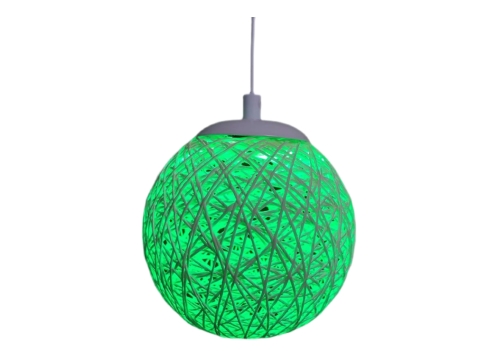

        When generating a PCB design, you should consider what the physical PCB will look like. Is it a square? Rectangle? round? There is no problem in making any whimsical shape. We encourage you to use your own ideas and creativity to design, but please note that the size of the board should be controlled within 10cm*10cm, so that you can Jialichuang is making boards for free ! During the design of this case, the night light purchased on the online shopping platform was disassembled and designed based on the internal structure. A 5cm rounded rectangle was made with a 10.5mm hole in the middle for fixation. During the actual design, you can also use it according to the design. Renovation and design of existing lighting products.
Figure 3-2 Online shopping night light model and frame design
