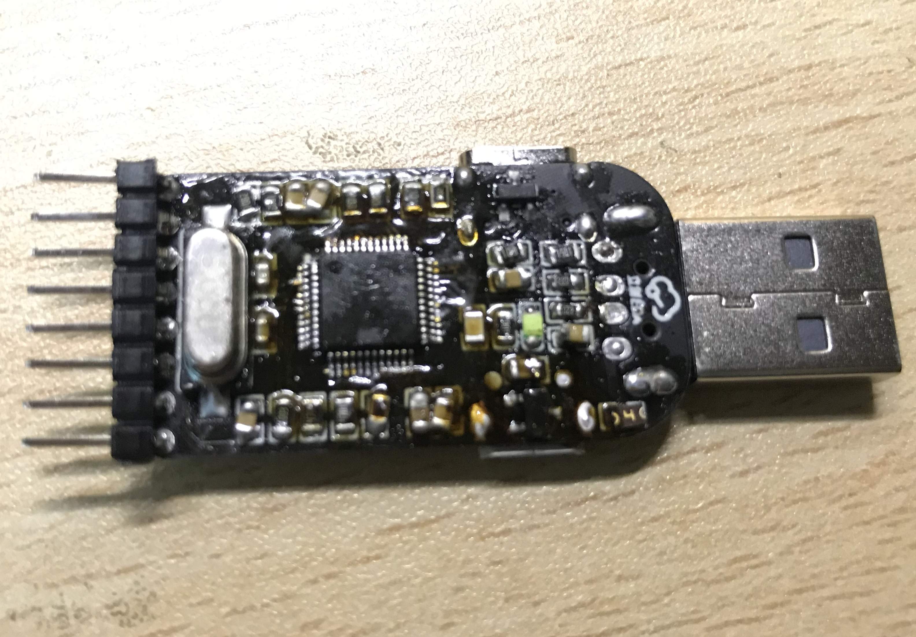

image.pngimage.pngimage.pngimage.png Solder it yourself, I'm only talking about the burning process here

Connect the stlink downloader you are currently using, and connect the four wires 3.3v, swdio, swdck and gnd.
These four lines are connected to the 3.3V GND of the download board and the DIO and CLK marked in red.
(After I connected 3.3 and gnd with Dupont lines, I used the two extra Dupont lines on SWDIO and SWDCK to connect to DIO and CLK)
Similar to the following, remember to plug in 3.3V and GND. I didn’t plug them in in the picture (because I was writing a tutorial)
