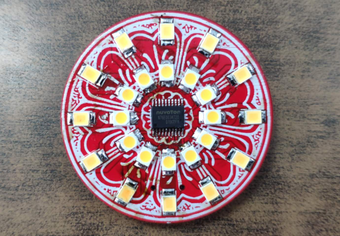

Special attention!!!!!!! N76E003 requires a downloader to download. Ordinary serial port cannot be used to download the IAP firmware without burning it.
The previous version was too difficult to solder the QFN chip, so it has been revised now, and the circle diameter has been changed from 28 to 42mm, the lamps are double, the lamp size is 3528 or 2835, the main control has been modified to the N76E003 I have, and the MPU6050 module is used
A big brother said that you need to add a solar panel, so I will lead out the 5V for you. You only need to ensure that the voltage of the solar panel is within 8V (the maximum input voltage of TP4056 is 8V, if it exceeds it, the 4056 will be burned). Generally, you need your solar panel The voltage is preferably 4.5-7.5V
The program has not been written yet, but the hardware test is OK. After the program is written, you can make samples and choose materials. Don't type or buy materials now.

The following is a physical display:
Warning, the chip cannot be recognized. I have replaced several chips. I will try to solder a separate chip tomorrow to see if there is a circuit problem.
2021,08,11; 14:12stay
The problem is solved. Because the interrupt pin of MPU6050 is connected to the downloader, just delete the MPU6050 interrupt pin.

There is no way to control the brakes. I can't figure out how to judge the brake control. The bicycle must be vibrating during operation, which will cause the acceleration of all six axes to jump. It is impossible to judge whether it is braking or not. Could it be that they use a separate sensor (such as Is mercury measured by placing it in a horizontal position?
The completed lighting effect now is: (The degrees here refer to the degree of inclination, not the absolute angle)
1) The normal breathing light is between turning 10 degrees left and turning 10 degrees right
2) Turn left 15 degrees, the 4 lights on the left will flash; turn right 15 degrees, the 4 lights on the right will flash.
3) Turn left 30 degrees, the single pointer turns left; turn right 30 degrees, the single pointer turns right
4) Turn 40 degrees left and 40 degrees right, all lights will be on
For details, you can check out the attached video. I don’t know how to insert the video into the text.
