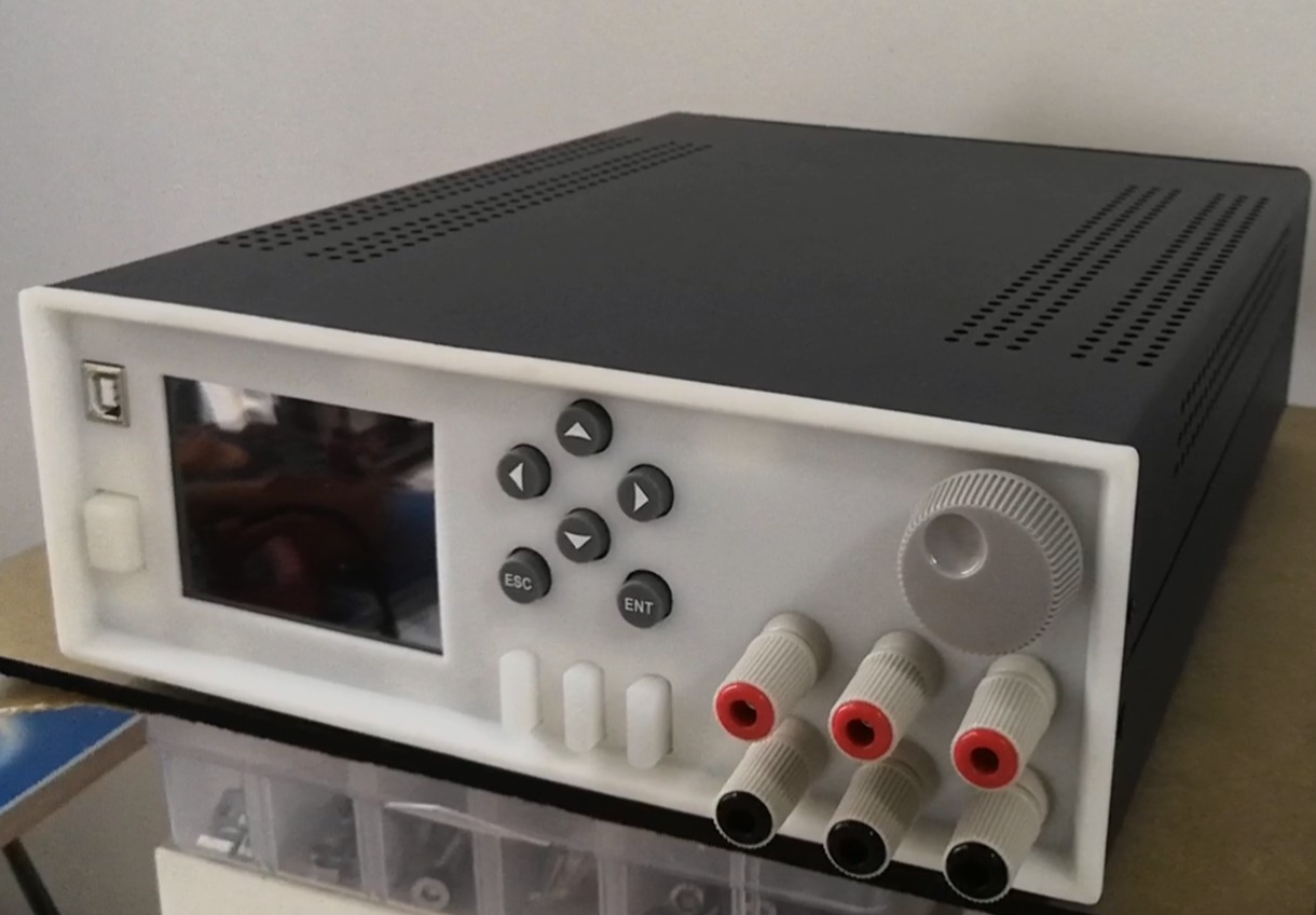

The problem started when the 3-way DC power supply IT6322 that I had been using on my desktop broke down, so I was always short of power supply. I originally wanted to replace it with another one, but I happened to see that Lichuang’s electronic design competition had a DC power supply category. So the idea of ​​DIYing a multi-step control power supply naturally came up, and I just took this opportunity to test my ability level.
The initial plan is to design it according to IT6322. IT6322 has three outputs, two 30V, 3A, one 5V, 3A. The voltage output accuracy is 0.01V and the current output accuracy is 0.001A. The operation interface is planned to be controlled by a 3.5-inch LCD screen and a touch screen. Of course, silicone buttons must also be brought. Sometimes it is better to use buttons (design them first to avoid finding that the touch is not easy to use later). There is no need for a physical numeric keyboard. It is more comfortable to use the direction keys to adjust the digits and the rotary encoder knob to adjust the digits. The GUI uses EMWIN. The communication interface uses USB. Ignore other interfaces for now and meet your own needs first. The communication protocol uses SCPI, which can be compatible with other instruments and save the workload when building a test platform.

8. Power supply structure design and accessories selection
After the schematic is designed, the components and accessories need to be determined, and then the internal structure of the power supply and the size of the whole machine need to be determined.
Next consider the internal structure of the power supply, and then design the PCB according to the internal structure. First, the design drawings of the transformer are given to the manufacturer. The manufacturer estimates that the size of the transformer is 70mm in height and 130mm in diameter. Then calculate the maximum heat dissipation requirement of the radiator. First, the maximum voltage drop on the power tube is 8*1.414=11.312V, and the maximum current of each channel is 4A. Therefore, the maximum power dissipated by the three channels on the radiator is 8*1.414 *4*3=135.744W, so the radiator must be large enough and the fan must have high air volume. Finally, learn from the method of IT6322, use a 60mm square radiator, and then fix the fan directly to one end of the radiator to achieve the best heat dissipation effect. The heat sink is directly fixed to the PCB and placed aside, leaving the remaining space for components. If one PCB cannot fit, you can consider two layers. The bottom panel is the power board, and the top panel is the control panel. This way the structure is clearer and can save a lot of space. The temporary layout diagram is:
The structure of the power board is basically determined. Now let’s look at the operation panel. There are 6 binding posts, 9 silicone buttons, 3.5-inch screen, power switch and USB communication interface on the operation panel. After a rough estimate, the width cannot be less than 200 , if it is so wide, there will be 200-60=140mm width free on the power board. One board can completely accommodate everything, so the power board decided to use one PCB. This way, compared with the upper and lower layers of the board, , more convenient for debugging and installation, and saving costs. After roughly determining the layout of the power board and the operation panel, the dimensions of the chassis are: the width should be greater than 200mm, the length should be greater than 260mm, and the height should be greater than 70mm.
Next, let’s design the appearance and layout of the operation panel. First, select the binding posts:
Then select the knob, knob cap and power switch:
Next, choose the buttons. The selection of buttons takes a lot of thought. If you use hard buttons + keycaps, you can have them readily available, or you can buy and design them. for example:
However, the operating experience is not as good as the commonly used silicone buttons on instruments. Generally, silicone buttons are custom-made from molds, and it is difficult to find universal ones. I finally found a few that meet my requirements on Taobao, but the height of the buttons is not uniform. Moreover, one button is used with a tact switch, and the other one has its own conductive black particles, which makes it difficult to unify the drawing board:
So I continued to search, and then I suddenly thought that the silicone buttons on the remote control could be used, so I bought two remote controls:
I took apart the remote control, took off the silicone buttons and tried it, but it still didn't work. I searched around again and had no choice but to use the original direction buttons. Because the heights of the direction keys and translucent keys are different, and considering their fixation issues, we first drew three small fixing plates:
With a fixed plate and a separate touchpad, the problem of inconsistent key heights can be solved.
But the direction keys are used with the tact switch, so they are specially equipped with conductive black particles:
Glue the conductive black particles to the direction buttons. After assembling them all, I tried it and the effect was good. In this way, everything about the power board and operation panel has been determined, that is, the overall structure and materials have been determined. Next you can draw the PCB.

On August 15th, the general design of the GUI was completed, and we could start joint debugging of the power board and display board.
On August 25, the power supply function was generally completed. Start optimizing, organizing data and shooting videos.
