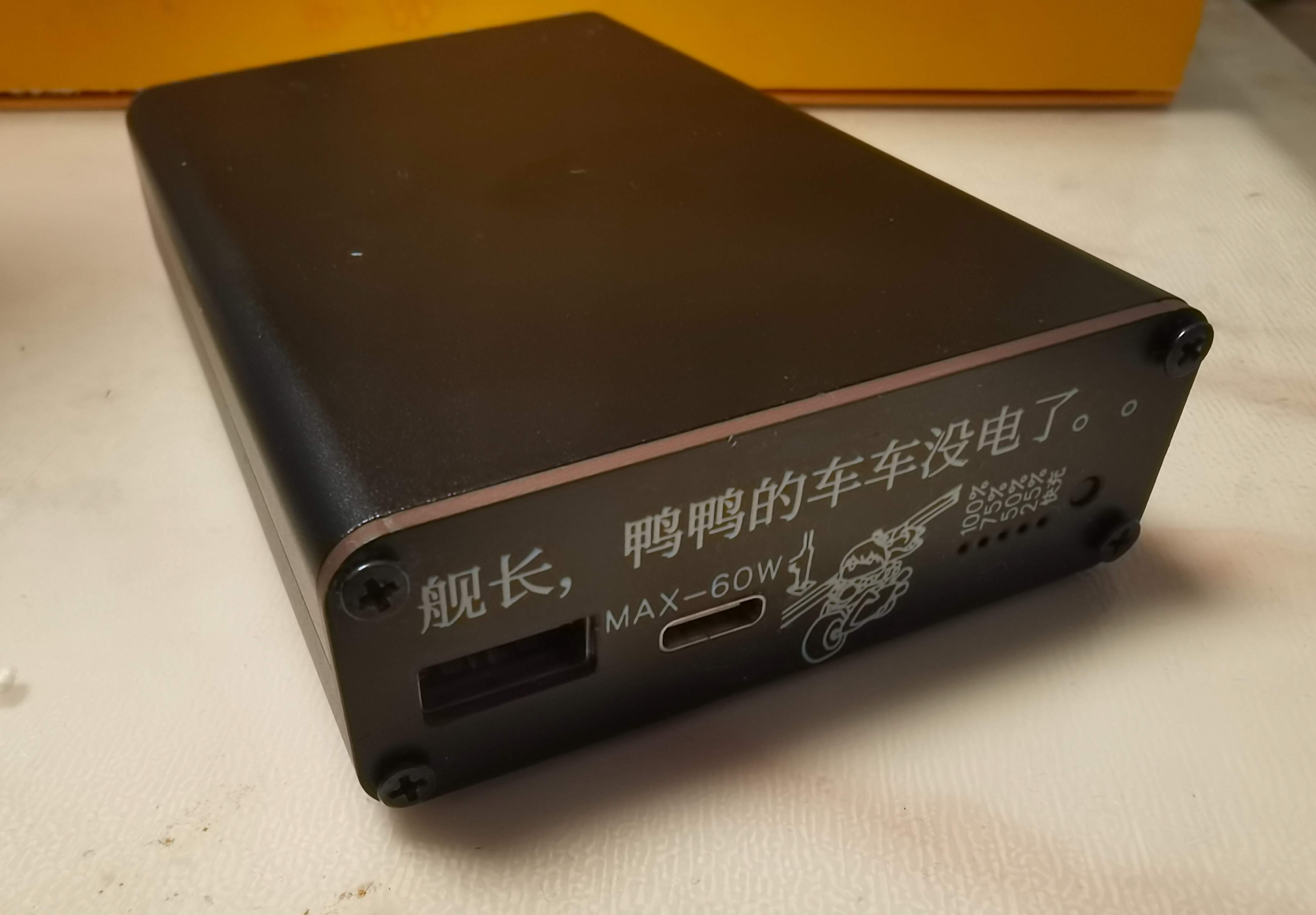

The 3-string 21700 mobile power supply solution based on IP5389-bz supports up to 20v3a. It has been verified that it works well after being used for a long time. I think the size, weight and capacity of the 3-section 21700 are well balanced and suitable for daily use.
The outer casing is an aluminum profile with a size of 71*25.5mm. You can definitely find it on Taobao and the price is not expensive.
Remember to add a lithium battery protection board to the battery pack. If possible, you can use high-end batteries such as Samsung 50e.
Notice! ! ! ! ! ! ! ! ! !
This shell does not support Lishen 21700
Lishen 21700 is a little thicker than the ordinary 21700, so it can’t be stuffed in.
Also, without adding emarker for power supply, the PD output is only 3a.
