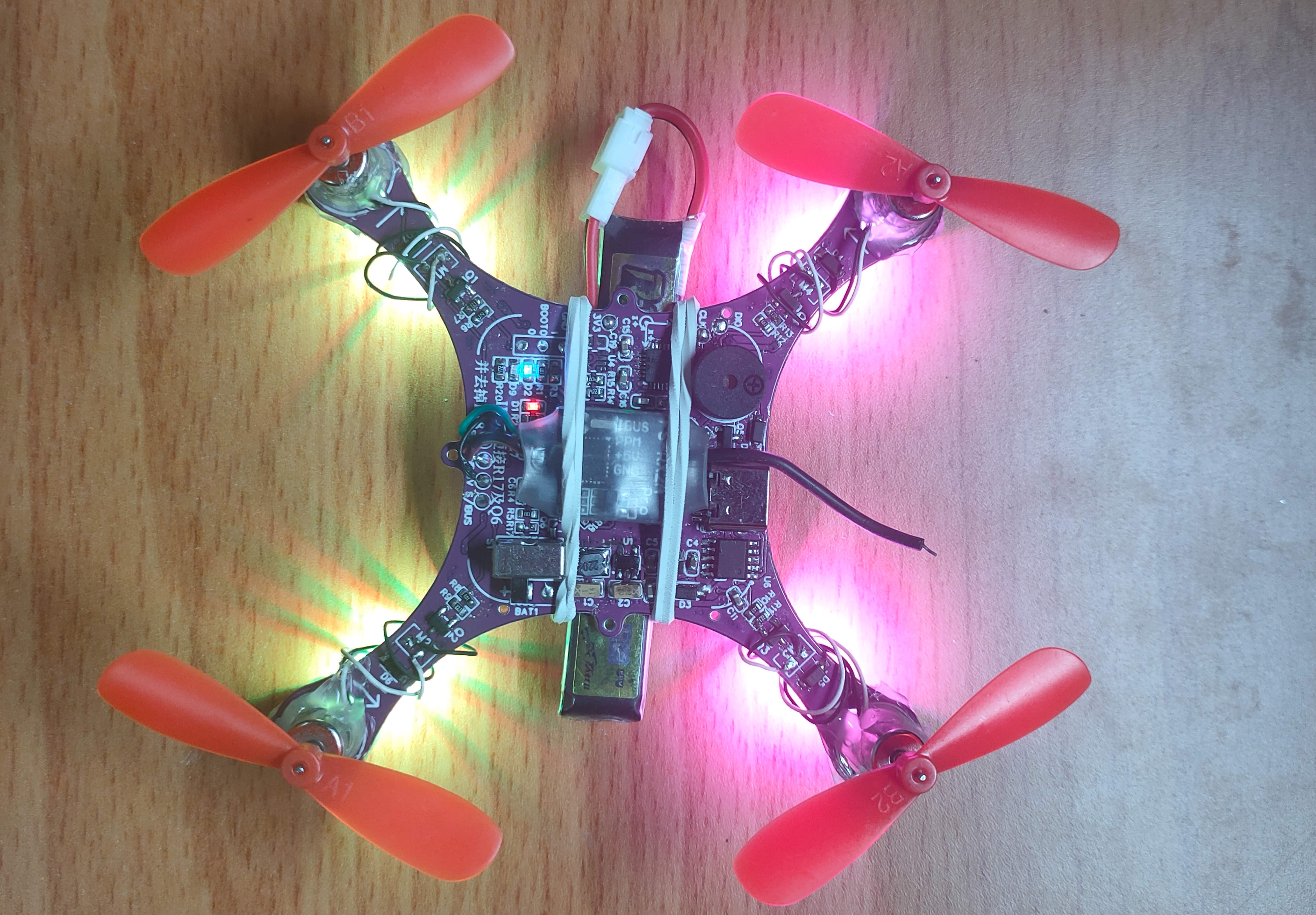

Physical map:
I have marked the rotation of the motor with silk screen on the new version of the PCB. For the installation of the propeller, please see my photo below.
To put it simply, the wind has to blow downward, otherwise it won’t be able to fly. The motor rotation can be reversed by exchanging the two wiring connections of the motor.
If the propeller is marked AB, you can install it according to my method. If it is not marked, just look at the circled part. The high position of the propeller can be the same.
Takeoff pictures:

V1.1 version
V1.0 and V1.1
V1.1
Mainly to test the functions of WS2812 and buzzer (the buzzer cannot be used)
Lighting description: The direction of the pink lamp bead is towards the machine head. It displays pink when it is not unlocked and blue when the motor is unlocked.
                 Green represents the battery level. It is green when fully charged and red when there is a low voltage warning. In between, it is a gradient color, such as yellow or orange.
                 You can also set the lighting function yourself in the BF parameter assistant software, and the parameter configuration file will also update the lighting.
Untested functions: The SBUS function has not been tested. The RX2Apro and FLi14+ I have cannot seem to output SBUS. The IA10B can output SBUS but it is too large, and I installed it on an F330 aircraft.
Possible problems: I don’t know if the SBUS inverter is redundant. If the SBUS output from the receiver is already inverted, then the negative will be the positive. SBUS is an inverse logic level. It is recommended to use PPM. Can save a triode.
Known issues: The motor base of the 716/720 motor cannot really fit into the fixing hole. It feels like it is specially used for the 8520 motor. If you use sandpaper, you have to grind off at least half of the thickness of the 3D printed motor base. Currently, it is heated Fixed with melt glue. The battery and receiver are fixed with rubber bands (because I don't know how to design these fixing holes at the moment, I just use the fixing holes of the original PCB). It is not impossible to fix it with hot melt glue, but it is recommended to use high-temperature hot melt glue above 100°. The hollow cup is still quite hot after running for a long time. It feels like 60 or 70 degrees. Ordinary hot melt glue will soften immediately.
