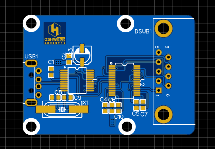

USB to RS232 module based on CH340T
  1. Use CH340T to convert USB to TTL, and then use ADM213 to convert TTL to RS232. ADM213 can be replaced by MAX213/SP213/MAX211.
  2. In the circuit, all nine pins of RS232 are connected to signals, which makes the wiring more complicated. In actual use, in most cases, only pins 2, 3, and 5 of RS232 are used. In this case, MAX232/ICL232/SP232 can be used instead of ADM213. In this way, due to the reduction of chip pins, the wiring complexity can be greatly reduced and the circuit scale can be reduced.
参考设计图片
