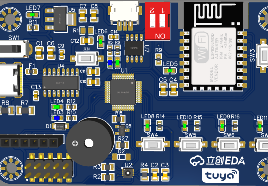

[Tuya Smart] Temperature and humidity sensor (MCU) based on Tuya Smart
  • Function description:
  • 1. You can check the indoor temperature and humidity status through your mobile phone, allowing you to better understand your living environment.
  • 2. Real-time display of temperature and humidity through OLED
  • 3. When the temperature and humidity are too high, the buzzer will alarm
  • 4. Display temperature, humidity and weather through dot matrix
  • Hardware Configuration:
  • MCU: STC8A8K64S4A12 chip
  • USB to TTL downloader
  • With 0.96 OLED display
  • With 8×16 dot matrix display
  • The sensor uses SHT30 temperature and humidity sensor
  • An external 2K PROM memory model AT24C02
  • Buzzer is used to remind high or low temperatures
  • LED lights for status display
  • Press button to debug
  • The WiFi module uses Tuya Smart's WBR3 and can be connected to Tuya Smart APP for easier viewing.
