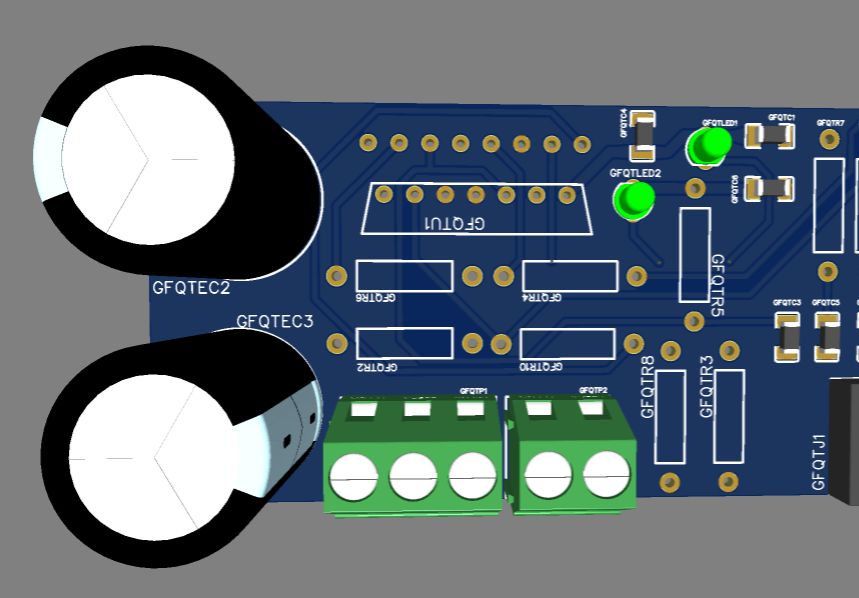

 1. Project description:
This is a power amplifier project based on the LM4766 audio power amplifier. At the same time, this is an excellent work in a school-level PCB design competition. The project draws the schematic diagram based on the official TI manual, and then hands it over to the students for PCB design.

3. Things to note:
1. In order to test the students' PCB practical operation, we have modified the package pad size of LM4766. If you want to use this open source project, please check the package of LM4766 and replace it with the chip package provided by Lichuang.
2. Since the chip has high power, please dissipate the heat of the board chip and increase the trace width according to the needs to avoid excessive current for a long time.
3. This project is a PCB design competition entry. If there are any deficiencies in the design of this project, you are welcome to make changes according to your needs.
