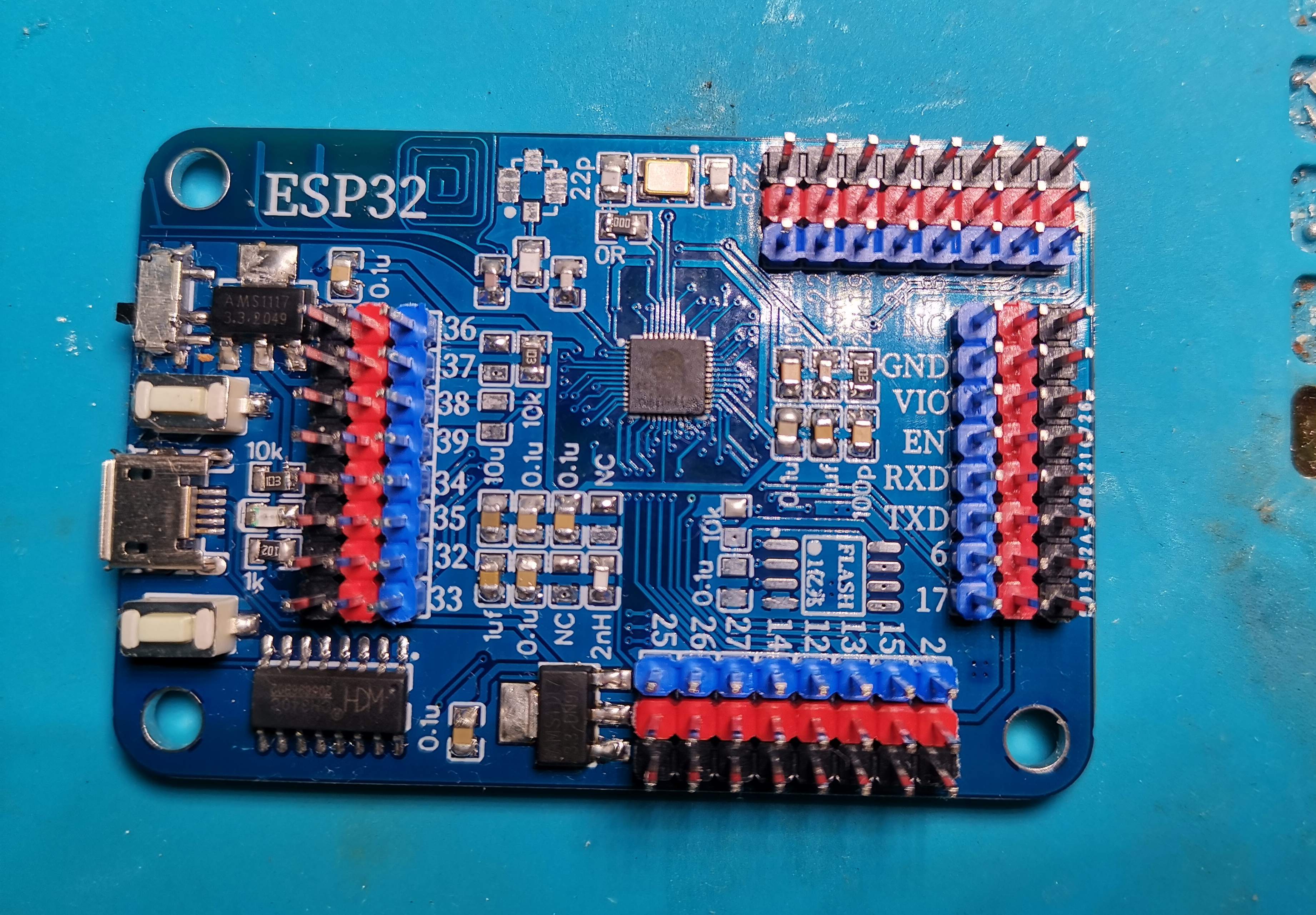

Develop test board for esp32 chip,
The board can weld the esp32D2WD model chip or the esp32D0WD chip + flash;
The chip size is 4*4 mm; it is difficult to solder and requires professional equipment and technology;
1.esp32D 2 WD model chip
Test the soldered esp32D 2 WD chip, the flash does not need to be soldered, the chip comes with 16 MB of memory and a 40 MB crystal oscillator;
To initialize the micropython firmware, you need to press and hold the button next to CH340C, and then power on again to directly upload the micropython code;
The c program of esp32arduino cannot be uploaded, and an error is reported when uploading. I don’t know how to solve it at the moment. If you know, please tell me;
The wifi has been tested and can be used within a distance of 10 meters;
2. esp32D 0 WD model chip
Test the soldered esp32D 0 WD chip, the flash must be soldered, the chip does not have its own memory, the crystal oscillator is 40 MB;
The c program of esp32arduino can be uploaded. When uploading, you need to press and hold the button next to CH340C.
