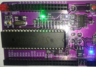

STC15F2K60S2 development board
STC15F2K60S2 system development board, with automatic download circuit, STC-ISP software does not require manual reset when downloading the program, the board is equipped with an ldo chip, 3.3V power supply interface, P54 reset button, and optional external crystal oscillator circuit. All IO ports are led out, the P0 port has been pulled up, and P1.0 is the onboard LED light.
The circuit was improved, and all the capacitors with small capacitance were changed to 0805 chip materials, leaving only one 47uf capacitor as a plug-in capacitor.
