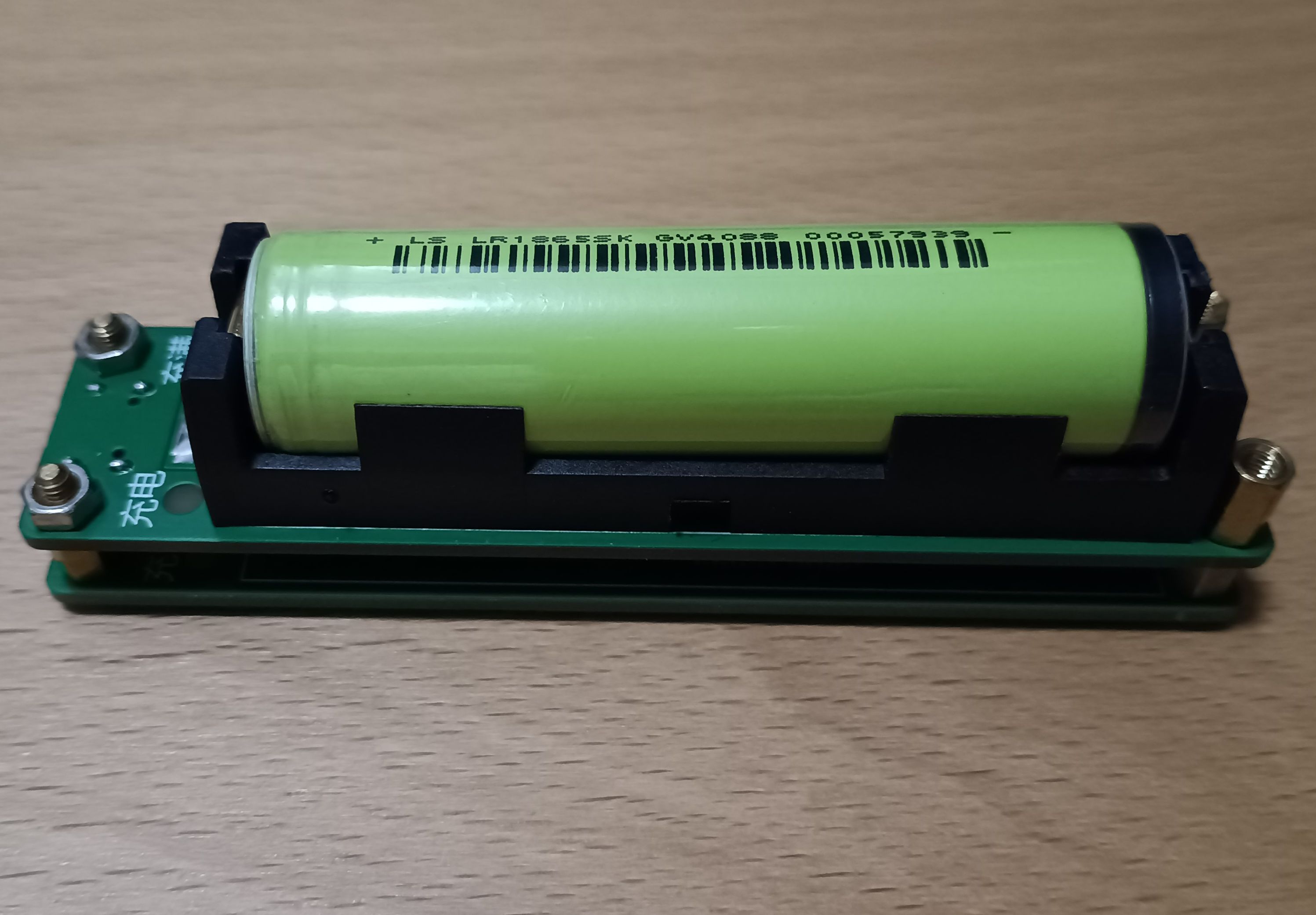

18650 lithium battery charger based on IP2312
There are also chargers with the same functions based on IP5303/IP5305.
18650 lithium battery charger based on Yingjixin IP2312. Compared with the linear step-down TP4056, the IP2312 with synchronous switching step-down charging is more efficient and generates less heat.
The charger is designed for fixed 4.2V batteries.
The charger is equipped with a battery reverse connection protection circuit. When the battery is reversely connected, LED2 lights up, indicating that the battery is reversely connected incorrectly:
Advantages and Disadvantages:
             Advantages: No heat at all Disadvantages: 1. The battery may be too old and the light will not turn on when fully charged;
            2. Power on and The charging indicator LED1 is all flashing, and it is impossible to tell whether the battery is connected or not.
Notes on welding:
Finished product:
