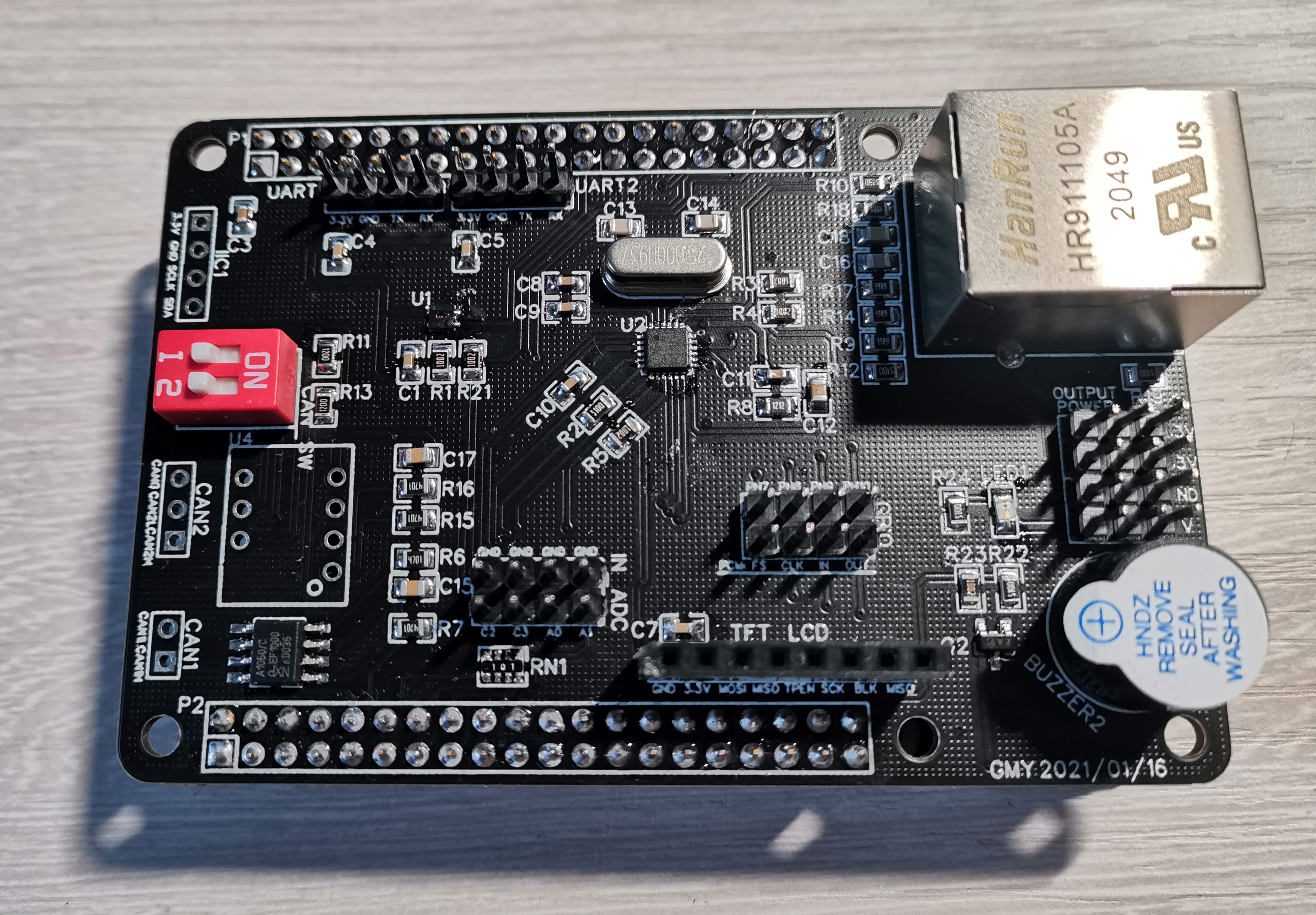

· Introduction to schematic module:
The interface, CAN and WLAN parts refer to the official expansion board ART-PI-DOCK V1.0
LCD part:
If you use Atom's 2.8-inch LCD, 34 pins will be used, and the interface from the core board is inconvenient to re-expand so many pins. In addition, I only brought home a 2.4-inch TFT-LCD during the winter vacation. , only using 8 pins, which is very convenient, so I chose the 2.4-inch TFT-LCD solution.
External ADC: (Deleted after modification)
This part is an interface reserved for future external 16-bit high-speed ADC.
Touch keyboard:
I have written a framework for driving the touch keyboard before. For the convenience of future use, I also added it together. Only two interfaces, SCLK and SDA, are used, which is very convenient to use.
Serial port module:
There are two external UART interfaces. I have never used CAN communication. Just in case, add two spares.
Temperature and humidity sensor
采用了SHTC3模块,SPI通信,仅需4根引脚,DataSheet中写到需要在SCLK和SDA引脚加上拉电阻,并且电源一定要退耦
buzzer module
Pull out the internal ADC for easy use
As for the expansion board, pull out the power supply as well.
Finally, take out the extra GPIO port that can be easily pulled out, including the PCM interface.
· PCB introduction:
The module is relatively simple, so I won’t go over the details here, but mainly record the knowledge learned. The layout of the main body is similar to the reference design. With so many pins, how to lay out and route the wires really gave me a lot of experience.
For example, how to route the wires from left to right neatly?
The reference design here cleverly uses vias to rearrange the order of wiring.
Regarding the problem of power cables and signal cables, the power cables are wrapped around the board and try not to interfere with the routing of the signal cables.
Lead out the redundant GPIO port separately, which is a big circle.
