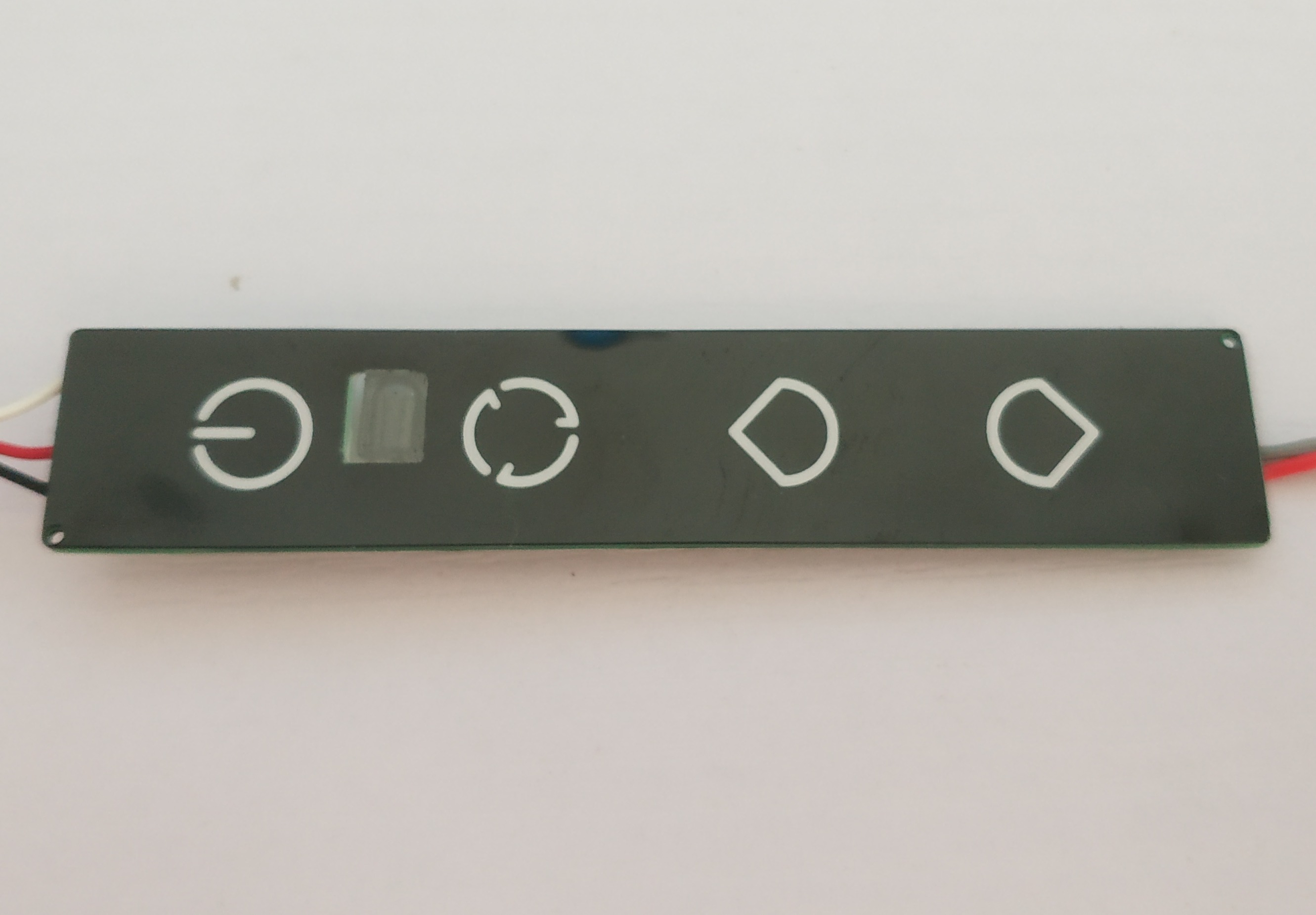

< br> < br> * 5. Upload project pictures
5.1. If the contest logo is not printed on the PCB, it will be deemed as giving up the participation.
IMG_20200911_141959.jpg           5.2. Other pictures of the project nameplate + PCB = module product
Demonstration of switching between warm and cold lights (see demonstration video for details)
Form a desk lamp (see the video demonstration for details. Since I only have a single-color white light desk lamp on hand, I cannot demonstrate the switching between warm and cold light. Please forgive me)
