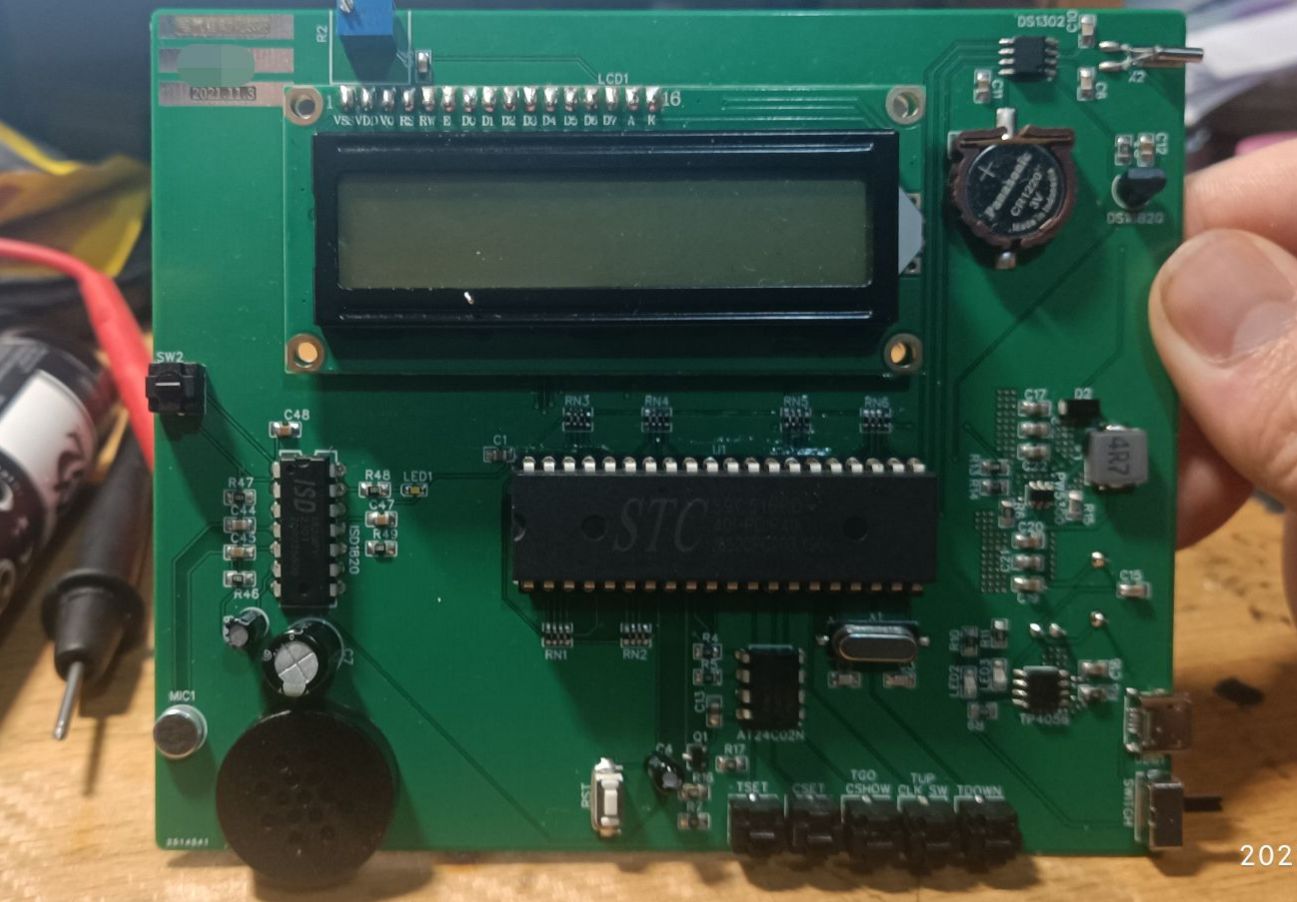

51 single chip microcomputer training project, temperature display perpetual calendar
Powered by a 3.7V lithium battery, the PW5300 boosts the voltage to 5V, and the TP4056 is used for charging;
Temperature sensor: DS18B20;
Clock module: DS1302;
Alarm clock storage module: AT24C02 (EEPROM);
Alarm clock ringtone module: ISD1820 (record the alarm clock ringtone directly, simple and crude);
Display module: LCD1602, with many routines to get started quickly.
[x] Schematic design
[x] PCB diagram design
[x] PCB proofing
[x] Welding test
[ ] function test
[ ] Program testing
