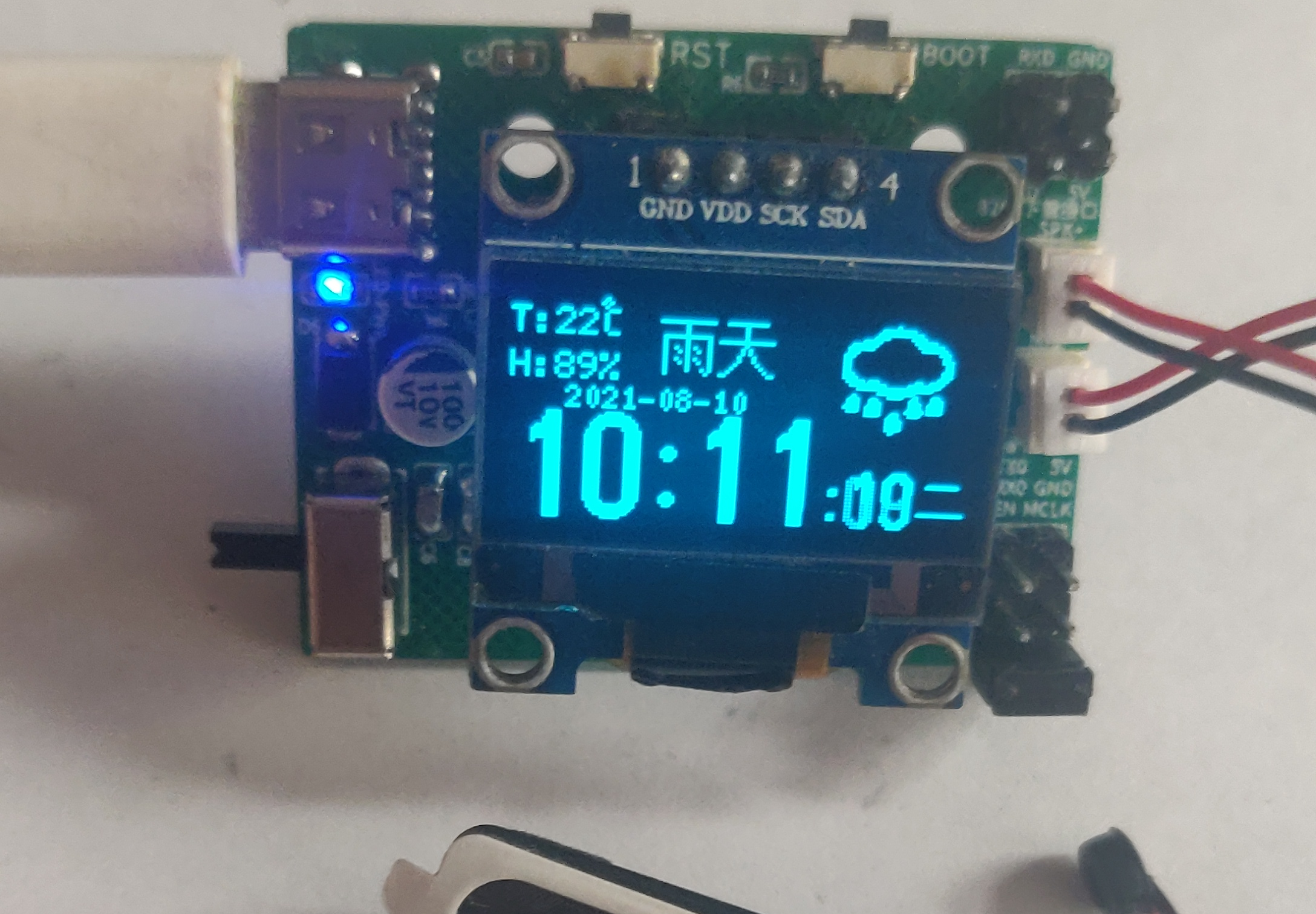

This is an online weather clock (offline voice control version) that can reply to a series of information such as the current "time", "month", "week", "temperature", etc. based on specific command words issued by the user.
Project design requirements and functions:
  1. Can display real-time time on OLED screen
  2. Support web configuration and reconfiguration
  3. Show weather
  4. Adjust screen brightness function
  5. Button to rotate screen 0 degrees/180 degrees
  6. Adjust screen brightness
  7. Respond to a series of information such as the current "time", "month", "week", "temperature" and so on based on the voice command words.
  8. You can set the volume according to the voice, and turn the voice on and off.
  9. Set usage prompt tone when powering on
  10. When waking up and exiting, there are specific voice announcements to remind the user.
  11. Designed in Mini style

  1. The main controller uses ESP8266-12F. The module core processor ESP8266 integrates the industry-leading Tensilica L106 ultra-low power consumption 32-bit micro MCU in a smaller size package with 16-bit streamlined mode. The main frequency supports 80 MHz and 160 MHz. , supports RTOS, integrated Wi-Fi MAC/ BB/RF/PA/LNA, onboard antenna. Supports standard IEEE802.11 b/g/n protocol and complete TCP/IP protocol stack. Users can use this module to add networking capabilities to existing devices or build independent network controllers. In addition, it only requires very few external circuits and can reduce the size of the PCB to the minimum, which is very suitable for making Mini products. Moreover, ESP8266 has a very good ecology and supports a variety of programming methods. Essence has provided ESP8266 IDE2.0 Development environment, it also supports Arduino IDE for development (this project is developed based on the Arduino IDE environment). In addition, Lua language, Python language, etc. can be used to develop ESP8266 control programs. image.png
  2. The offline voice part uses Qiyingtailun's CI-C22GS02S module. The control chip on the module is CI-1122. It has rich pin resources, supports custom wake words and command words, and also supports noise reduction processing. Price It is cheap, so this project adopts this solution for offline voice.
  • Design an independent button using the GPIO0 pin. You can use this pin to start the download mode or use it as an ordinary button to further save PCB space. Users can use this button to control screen brightness, flip and other functions.
  • Reserved ESP8266 serial port download interface and offline voice module serial port download interface
  • Use an OLED 0.96-inch screen with a total of 128*64 pixels. The aspect ratio is just right for displaying weather, time and other elements. You can also add some UI. The communication interface uses IIC communication and only requires 2 pins (not included). power and GND)
  • Using 5V USB-Type-C for power supply, there is no need to consider the issue of forward and reverse plugging. In addition, most Android phones on the market now use this interface, and users do not need to find additional power cords to adapt.
  • AMS1117-3.3LDO step-down chip is used. This chip converts 5V to 3.3V power supply, mainly to power ESP8266-12F.
  • The offline voice module comes with a 5V-3.3V DC-DC chip, so you only need to supply the 5V power supply to the offline voice module.
  • According to the offline voice module manual, capacitors and diodes need to be added to the peripheral circuit. image.png
  • Speakers and microphones use differential wiring
