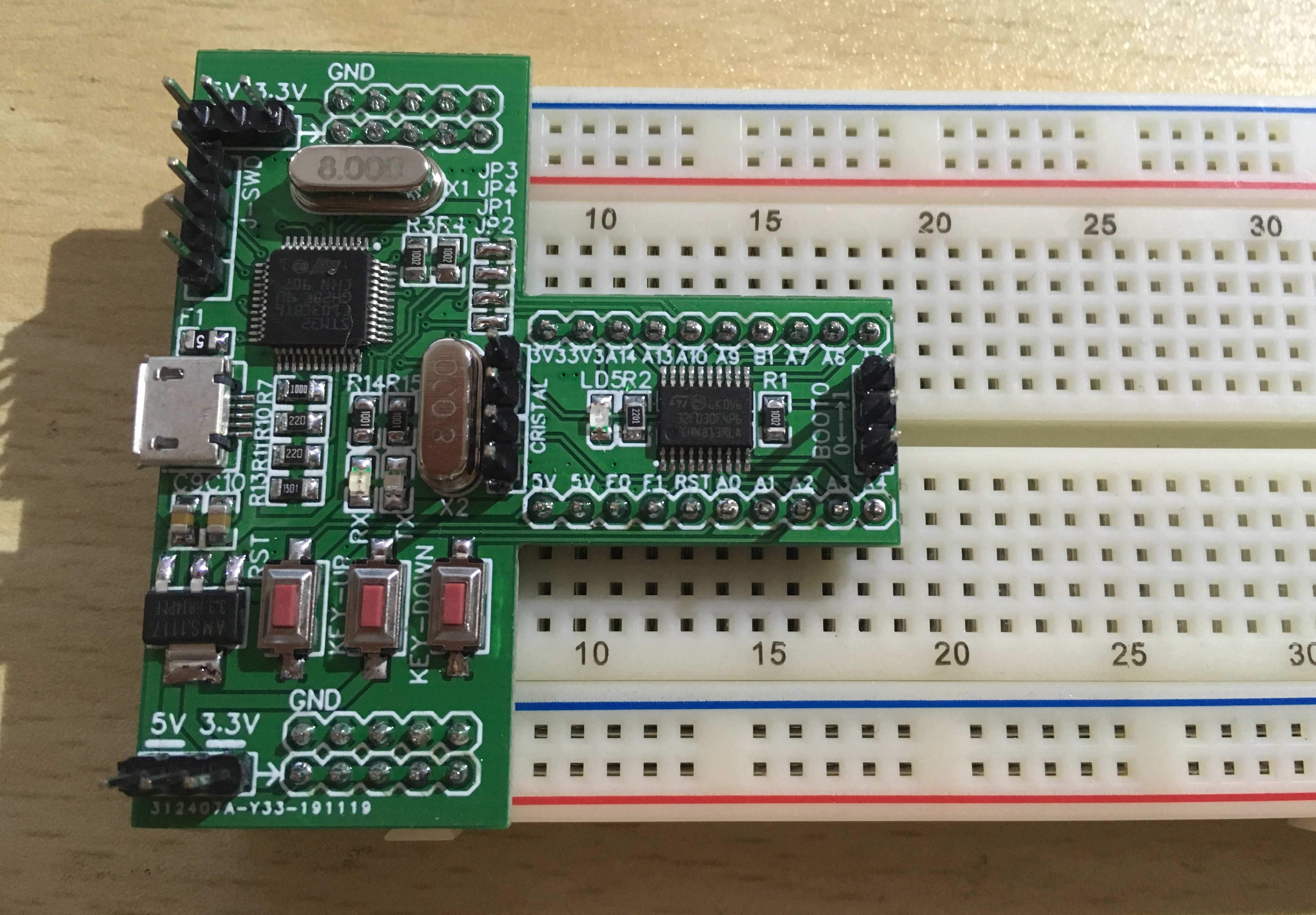

Proofing physical demonstration:
Welding finished product display
Can be mounted perfectly on a breadboard
Connecting other modules on the breadboard makes it easy to develop prototypes
