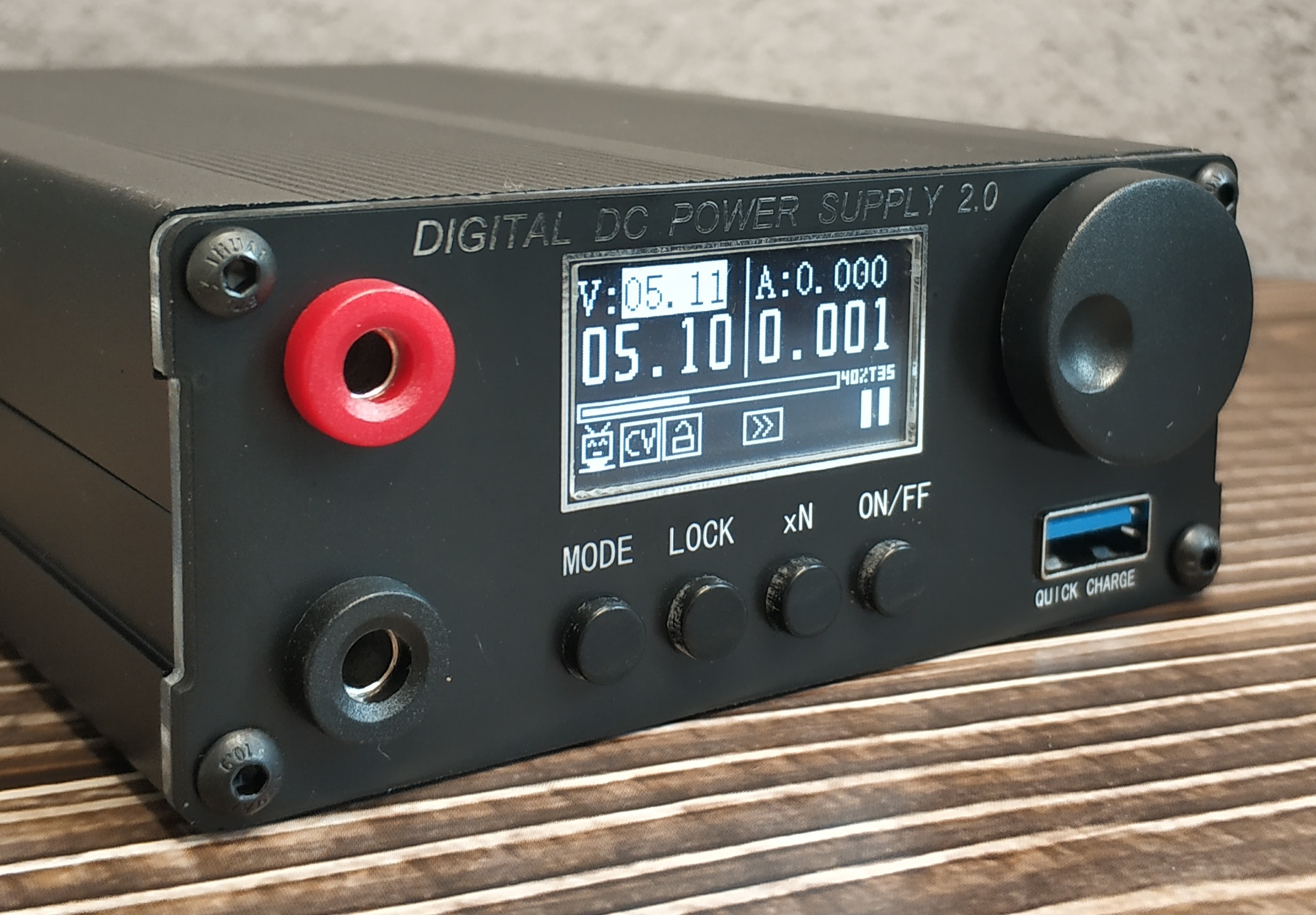

*7. Contest LOGO verification
Attached: Complete machine renderings
Note: This picture is a photo of the actual object taken when it was just completed. Later, on this basis, the constant current and constant voltage status lights were changed, and the color of the buttons was changed.
* 8. Demonstrate your project and record it as a video for uploading
Since the video size is required to be within 100M and the resolution is 720P, a single video can only be within 1 minute, so many details can only be briefly introduced. Using 5 times the playback speed, this CNC power supply is designed using standard accessories commonly used in the market. , instead of using a special casing, the entire mechanical structure is relatively complex, with many assembled parts. If you can’t clearly see the steps in the video during the assembly process, you can learn the structural details by pausing multiple times.
