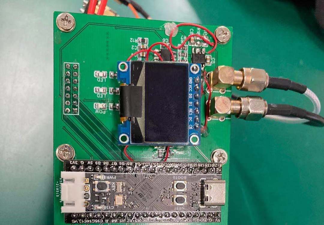

This differential amplifier circuit tester uses STM32F411 as the microprocessor. By inputting different signals to the differential amplifier circuit and measuring the amplified signals, it completes the measurement of the amplification factor, input resistance, and amplitude-frequency characteristics of the amplifier circuit. At the same time, the tester can also be used as a sinusoidal differential signal generator, which can generate a sinusoidal differential signal with adjustable frequency and amplitude. The common mode signal is obtained after PWM low-pass filtering, and the differential mode signal is generated by AD9833. At the same time, input the common mode signal and the differential mode signal into the addition and subtraction circuit to output the differential signal. After the differential signal generated by the differential signal source passes through the differential amplification circuit, it first passes through the subtraction circuit to filter the common mode signal, and the resulting differential signal is high-pass filtered, maintained by the peak detection circuit, and then detected by the ADC. STM32F411 is responsible for controlling the measurement process, analyzing and processing the measured data, calculating the input and output resistance and frequency characteristics of the differential amplifier circuit, and drawing the corresponding characteristic curve through OLED to complete the characteristic test of the differential amplifier circuit. This system has the characteristics of low power consumption, low cost, convenient control, friendly human-computer interaction, and stable working performance. It can be regarded as a superior solution for differential amplification circuit tester.
1. System solution design
1.1 Differential signal source 1.1.1 Proposed solution 1: Obtain the DC signal through resistor voltage division, and obtain the DC signal through the voltage follower and the co-directional amplifier. STM32F411 controls AD9833 to generate a sinusoidal signal with adjustable frequency and phase. After following the voltage through a voltage follower, a digital potentiometer is used to divide the voltage. The amplitude of the sinusoidal signal can be controlled by changing the resistance of the digital potentiometer by pressing a button. Input the DC signal and sinusoidal signal into the addition and subtraction circuit respectively, and output the differential signal source.
Scheme 2 STM32F411 controls DDS to generate a sinusoidal signal with adjustable frequency and phase offset. After following the voltage through a voltage follower, a digital potentiometer is used to divide the voltage. The amplitude of the sinusoidal signal can be controlled by changing the resistance of the digital potentiometer by pressing a button. Since the DDS used here can adjust the offset, the DC signal is obtained after low-pass filtering. The DC signal and the sinusoidal signal are input into the addition and subtraction circuits respectively, and a differential signal source with controllable frequency and amplitude can be output.
Option 3: Low-pass filter the PWM signal to obtain a DC signal, and the DC signal value can be changed by controlling the duty cycle. STM32F411 controls AD9833 to generate a sinusoidal signal with adjustable frequency and phase. After following the voltage through a voltage follower, a digital potentiometer is used to divide the voltage. The amplitude of the sinusoidal signal can be controlled by changing the resistance of the digital potentiometer by pressing a button. By inputting the DC signal and the sinusoidal signal into the addition and subtraction circuit respectively, a differential signal source with controllable frequency and amplitude can be output.
1.1.2 Comparison and selection Among the above three options, except for option 2, AD9833 is used to generate differential mode signals. However, option 2 requires fewer DDS chip models that can adjust the offset size, so option 2 is abandoned first. The method of generating common-mode signals in Scheme 1 is to divide the voltage through digital potentiometers. The common digital potentiometers on the market have a 100-level order. The common-mode signal required by the question is exactly 100-level. Therefore, if you want to use digital potentiometers, When the potentiometer divides the voltage, the voltage at both ends of the potentiometer should change within the range, and the accuracy requirement is relatively large. Moreover, any common mode signal input by the user cannot be generated, so option one is abandoned. Solution 3 uses PWM to realize the function of independently adjusting the DC signal value. Here, PWM can be generated by AD9833 or STM32. Taking into account factors such as circuit implementation and code implementation, we believe that using STM32 to output PWM wave is the best solution. Option 3 is a better option.
Considering that the digital potentiometer does not accurately divide the resistance, there will be a certain error in the output of the differential mode signal, and there will also be a certain error in the PWM filtering. The above two errors can be eliminated through software, and the measured The parameters corresponding to different outputs are recorded in the MCU. When a specific signal needs to be output, the comparison table is searched to determine the parameter settings, thus ensuring the accuracy of the output as much as possible.

  1. Test plan and test results 4.1 Test the differential signal source When testing the differential signal source, directly use wires to connect the two outputs to channels 1 and 2 of the oscilloscope, and use the subtraction operation in the math function of the oscilloscope to observe the differential to single-ended signal , compare the differential mode signal amplitude measured by the cursor with the actual set differential mode signal amplitude to determine whether the output differential mode signal meets the requirements.
Figure 4-1 shows the amplitude of the actual differential mode signal when the output differential mode signal is set to 50mV. At this time, the error is 2mV, which meets the requirements. Using this method to continue measuring, we can conclude that the differential signal source we calculated meets the design requirements.
4.2 Test the differential signal detection circuit. Use an oscilloscope to measure the actual output of the differential amplifier circuit and the output after passing through the peak detection circuit, as shown in Figure 4-2.
Extrapolate the output of the peak detection circuit to the actual output, and calculate the error between the two. After multiple calculations, take the average and get: the difference between the output of the peak detection circuit and the actual circuit output is about 2.3mV, which is within the acceptable range.
4.3 Test system function Use wires to connect the tester and the circuit under test, and perform tests multiple times. Calculate the total time for a complete measurement, record the measurement results obtained from each measurement, and calculate the variance. The average system time measured was 23.4s.
It can be seen from the measurement results that the system runs quickly, and the variance of each parameter is small under different measurements. This shows that the system operates stably and the measurement result deviation is small.
