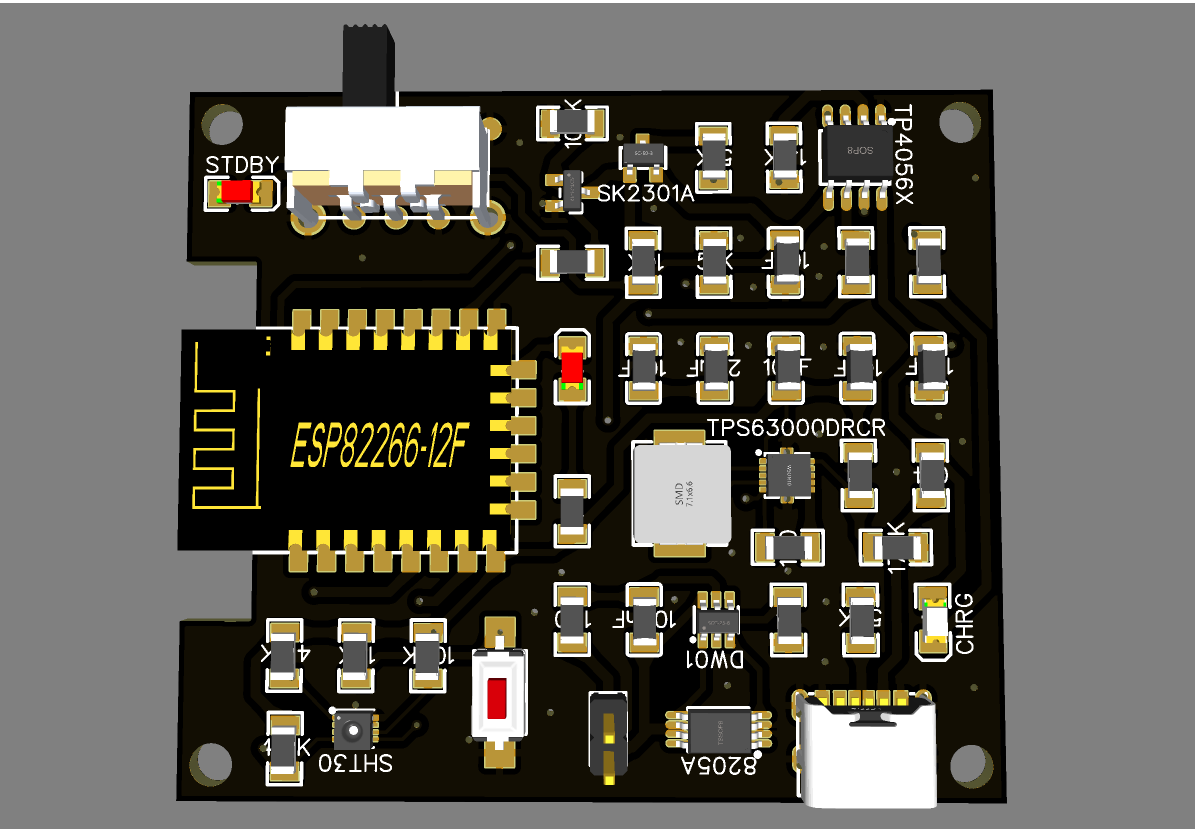

The battery-powered IoT temperature and humidity sensor linked to the Tuya Smart Platform communicates through the Tuya Smart WIFI module
temperature sensor
The temperature sensor uses the "SHT30-DIS" high-precision sensor with IIC digital output from "Sensirion (Switzerland)" and the external circuit is simple

power supply
The power supply is divided into two parts: "Battery & Charging" and "DC-DC"
The power monitoring circuit uses two 51K resistors to divide the voltage to adapt to the main control end ADC input voltage range.

And add a MOS tube controlled by a triode to save electricity

The battery part uses battery protection IC "DW01" and dual MOS tube "8205A" to protect the battery.

And charge the battery through a "TP4056X"

DC-DC power supply section
The voltage of the lithium battery will fluctuate between 4.2V when fully charged and 3V when empty. In order to ensure the stability of the power supply voltage, "TI (Texas Instruments)" "TPS63000DRCR" DC-DC chip is used to stabilize the voltage.
